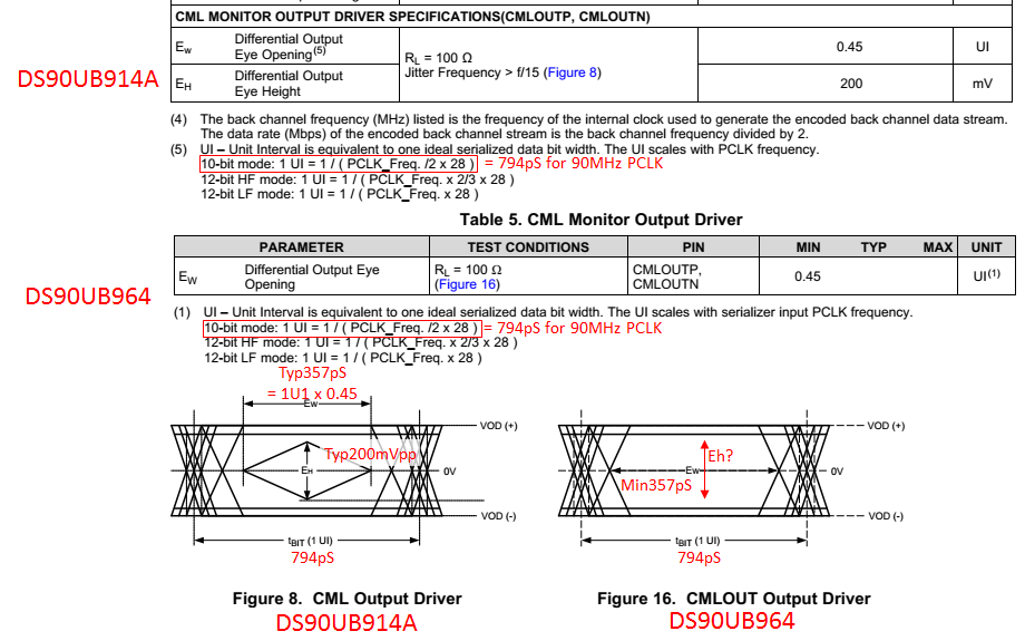

My customer has used multiple DS90UB914A-Q1 on board for their production unit. Now they are moving ahead with DS90UB964-Q1 for the future unit.
As it will be a direct replacement from 4 x DS90UB914A-Q1 to DS90UB964-Q1, it's assumed that similar receiver signal integrity should be required.
We compare the requirements on CMLOUT signal, few differences, such as typical and minimum difference, no Eh specification.
Can you help to clarify the requirement?
