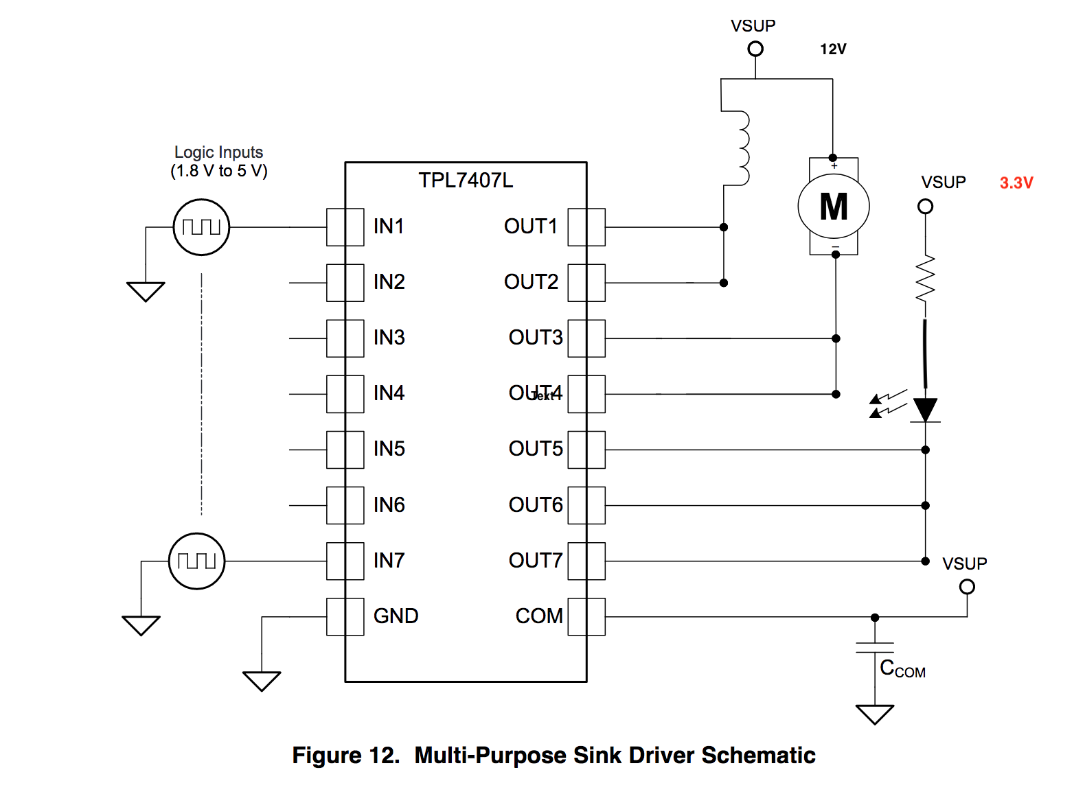

  • I also found COM Voltage min is 8.5V for the L and 6.5V for the LA.
    Question: can the loads be powered off of 3.3V like below.
    Is there a minimum Voltage for the load?
    Also, the Vin logic level high min is 1.5V. But datasheet mentions it's compatible with 1.8V logic level?
  • Hi Hithesh,
    You are correct, the COM voltage min has reduced as well, and this has also changed the VOL specs for the LA version.
    3.3V will work here. As long as the OUT voltage is lower than the COM voltage then there should be no problems.
    1.5V is the threshold where the channel is guaranteed to be ON (pulled low). Therefore, even if a 1.8V GPIO rail has +/-15% tolerance, the 1.5V threshold will work. If a 1.5V GPIO voltage is used, the variation may bring this below the 1.5V threshold.
