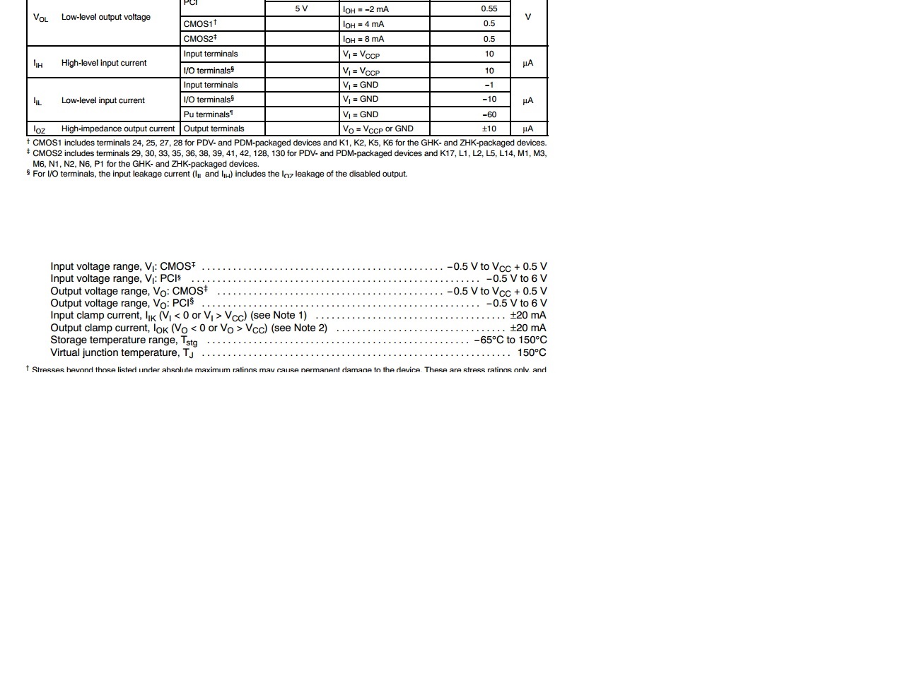

Hello support team,
Could you teach me the consumption current of PCI2050B?
I can't find out it on the datasheet.
