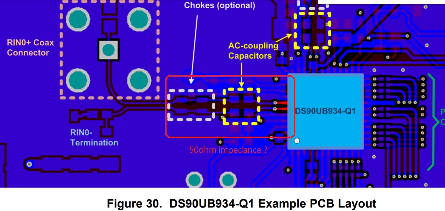

HI Sir
1. All of trace impedance on FPD side is 50ohm for single end application ,is it correct?
2. I have confuse about "As a secondary priority, loosely couple the traces with differential 100-Ω characteristic impedance"
this mean single end meat 50ohm and differential meat 100ohm at the same time on FPD side, is it correct?
