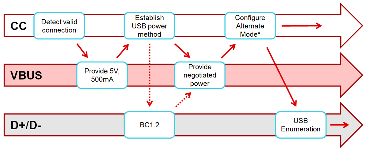

    I'm sorry we cannot change the BC1.2 detection timing in the TPS65986. It is not a configurable field. Our internal firmware will automatically handle the BC1.2 detection in the method shown in the picture below:

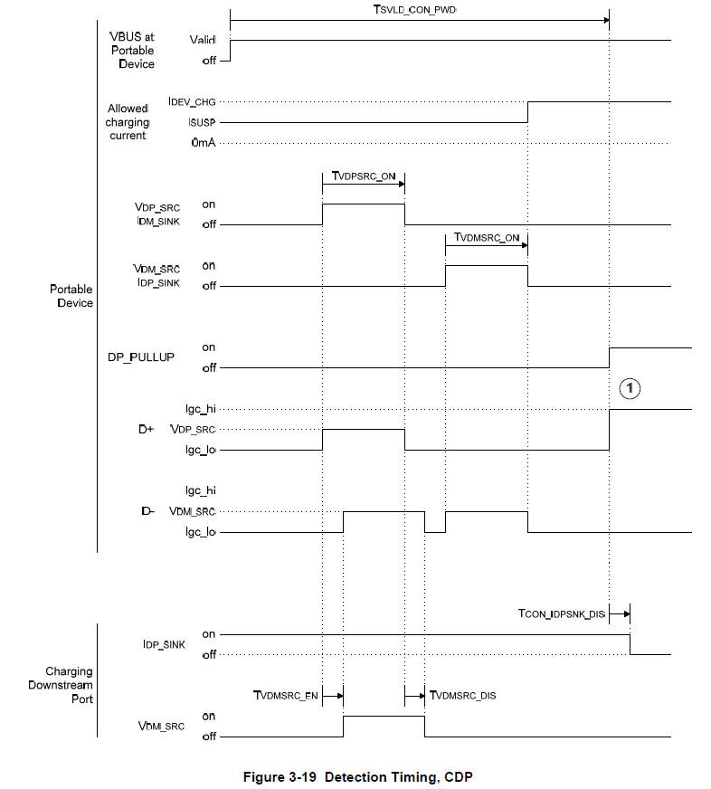

    As far as the timing of connection type, yes it is very quick. Here's a CDP timing diagram example found within the BC1.2 specification. The portable device starts the conversation by sending a signal on the shared D+ line.  The source device detects this, and sends a response back on the D- line. The Portable device receives this response, and to verify that the D+ and D- lines are not shorted together (DCP mode), it sends another signal back through the D- line. The source device receives this signal through the D- line, but does not send back a response. Since the portable device never received a signal back on the D+ line, it knows that the D+ and D- lines are not shorted together, thus it is in CDP mode.

  • Thank you, I now understand there is a series of events that must occur for primary and secondary detection.   However, the 1s is the max time that a PD must perform BC1.2 detection when plugged-in, doesn't necessarily mean that is how long we need to take, right?   Relevant timing for faster detection is TVDPSRC_ON + TVDMSRC_DIS + TVDMSRC_ON (40ms + 20ms + 40ms), not TSVLD_CON_PWD, right? The charger is only given 20ms to respond to DP/DM going high, which the portable device checks 40ms after it has turned on DM/DP in order to give the charger an additional 20ms buffer.
    Thus no more than 100ms should be “required” (120ms if we also give a 20ms buffer for the charger to turn off DM in response to DP going low).   Why does TPS65986 not begin BC1.2 detection immediately after VBUS is present?   Realizing that it may also depend on the Charger, not just our PD, but am I understanding the timings correctly, and doesn't it seem feasible that we should be able to complete detection significantly faster than 1s?    I appreciate your further clarification.

    As far as why theTPS65986 takes a full second to finish BC1.2 detection while the specification only shows 100ms is because the TPS65986 is a Type-C PD controller first and a BC1.2 device second. Its primary objective is to negotiate over the CC lines to determine the voltage it should supply to the sink device. All USB Type-C to legacy cables have a internal pull up resistor, which the TPS65986 detects and supplys 5V over VBUS since VBUS is always on for BC1.2. Then, the sink device begins the BC1.2 negotiation which the TPS65986 detects and then responds to. This is where the extra time is going.
