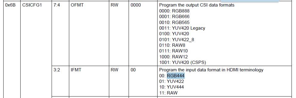

DS90ub940 can support RGB444 input in datasheet, if used DS90ub947 24bit RGB888 input ? ds90ub940 can do it ?

The DS90UB947 Serializer accepts OLDI (LVDS) on its inputs. To convert the 24 bit RGB888 (Coming from a graphics processor) to LVDS, you can use this part:
www.ti.com/.../ds90c387.pdf
Once the 24bit data is converted into LVDS, the 947-940 should be compatible with one another. The EVM user guides for the DS90UB947-Q1 and DS90UB940-Q1 are shown below, respectively:
www.ti.com/.../snlu140
www.ti.com/.../snlu162

UB947 can accept i.MX6's RGB888 video. my question is that why you set UB940 output RGB444? UB940 can support the RGB888 input and RGB444 output.
