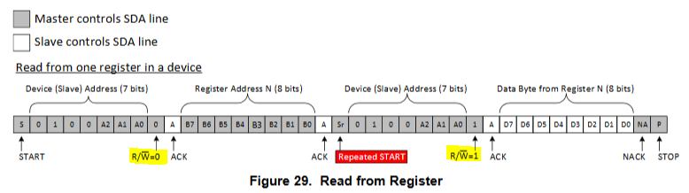

    Can you get us an o-scope shot of their SCL and SDA lines during their "failed" read transaction? I am wondering if they are initiating a read correctly as doing a read actually requires a write and then a read.
    You can see from the figure above that the transaction should actually be the device address followed by a write. Then the register you want to read from. Then a repeated start or a stop and then start again with the device address and a read bit. After this the data sent from the device will be the register you specified earlier.
    "My question is, regarding the Output Portx registers,  should the read status of the output register reflect the actual port status?"
    Yes, the output port registers should be the last bytes of data that were placed in them right before the last stop condition.
