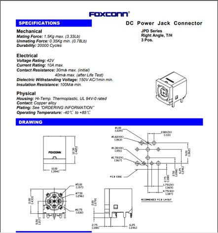

A customer is currently using the dev board to power everything over a USB-C connection with 5V and 3A, however, they need to negotiate 12V and 3A to power the device. They want to change the power supply’s connectors to match on the TI eval board. They have already found the exact female part to match, but now need to find the male part.
They need to find a source that fits the J4 Barrel-Jack Power Connector on the TPS65986.

  • Hi Hao,
    Thanks again for the response. I took the questions to the customer and they are wondering if they can buy just the connectors without the power supplies?
    I suppose they don't actually need the power supply itself.
    I think this should be a doable application.
    Let me know your thoughts.
    -Craig

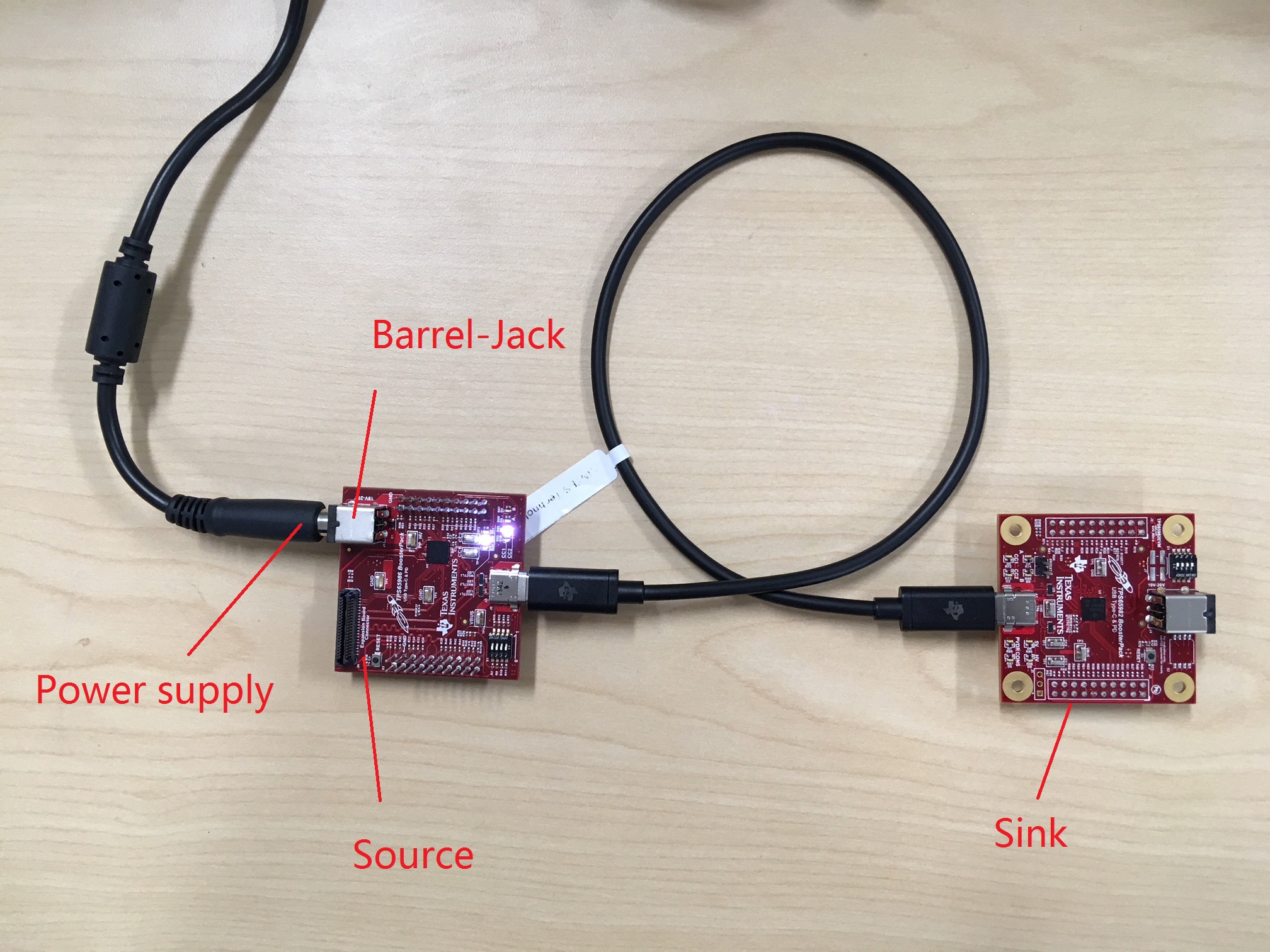

  • Hi Graig,
    The picture shows how TPS65986EVM works. If you want male connector for the barrel-jack, I'm sorry we don't have this product.
    I hope this helps and If this answers your question, PLEASE select  This resolved my issue
