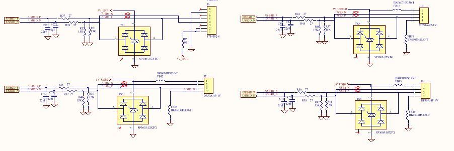

We have a board design using the TUSB2046B 4 Port Hub. The previous build of this board worked fine - the new build is from a different Contract Manufacturer and does not enumerate the Hub correctly.

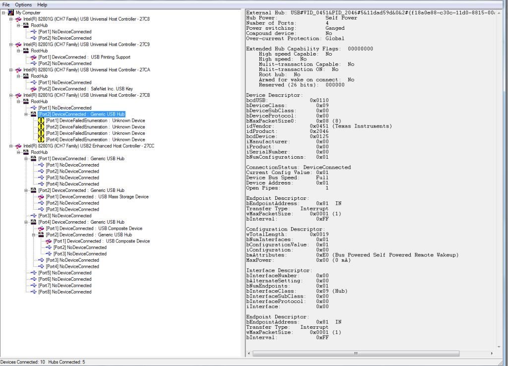

In Windows Device Manager, I get 4 Unknown Devices - each says : "Windows has stopped this device because it has reported problems. (Code 43)". There is no VID and PID recorded for any of them. (just shows up as USB\UNKNOWN. The previous board build just shows up as a single device (USB Hub).
Hub part of schematic is attached..
