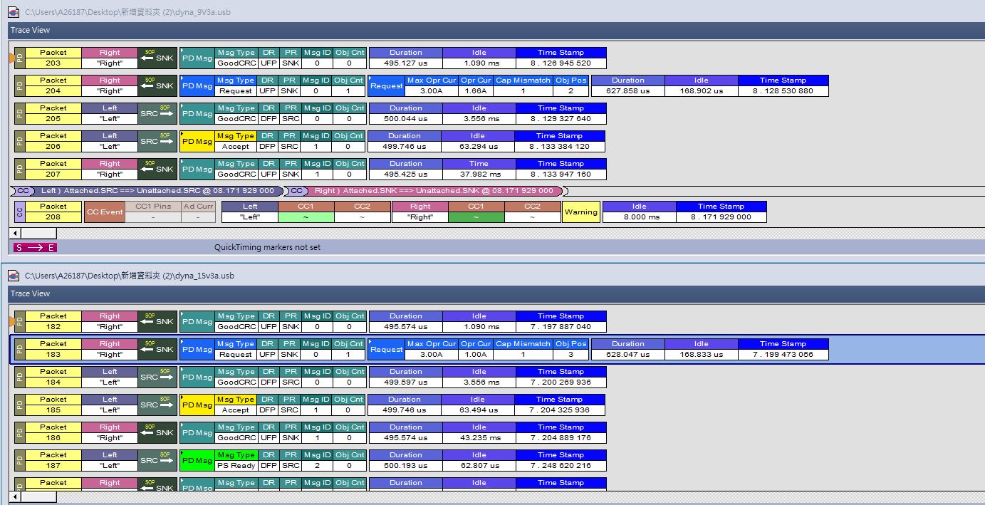

  • Hi Eric,
    Please check the link below about test result of 9V/15V. There're log(lecroy), pjt and bin.
    e2e.ti.com/.../dynamicpowertest.zip
    I see TBT's dock side reject 9V's connection. Maybe I'll modify sink's PDO as 9V1A to ignore dynamic power function and confirm 9V power supply?
    Gary
  • Hi Gary,
    From the logs, the issue is fairly clear. The PD Negotiation all looks okay. However, the Source never sends the PS_Ready message. This is because your Source voltage never reaches 9V. I suggest you monitor the voltage of VBUS and PPHV during this event to observe this. You would need to fix this issue with your DC/DC supply to make sure your board can supply the correct voltage.

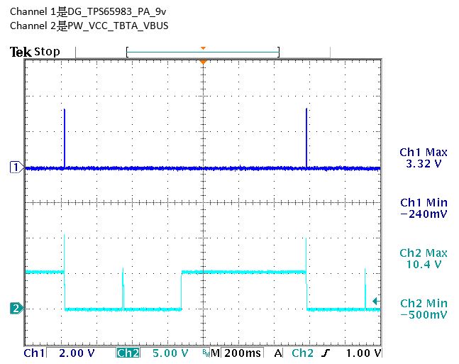

  • Hi Eric,
    1. Source side is intel's TBT AR reference design board.
    2. Please check the voltage in fig. You can see there's 9V shown on Vbus, but it's gone soon and retry to connect.
    3. Comparing log about 9V and 15V, there's no "power source ready" command sent from source side. Do you think 10.4V is not acceptable for 9V PDO?
