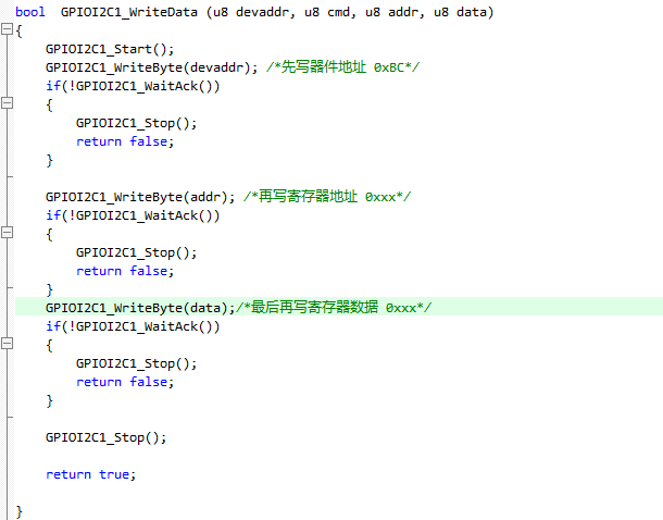

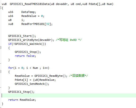

My customer is using TMDS181 and reported an issue abou I2C read/write issue.
1, checked the I2C read/write timing with logic analyzer and which can match the timing requirement in datasheet.
2, but when they read the register when system power on, the read out result is correct first time; when read the same register again, then the read out result is wrong.
3, when write the register when system power on, then the read out result of this register is wrong too.
4, customer mentioned they have followed the read and write operation in datasheet P33, 8.5.1.
So I have provided the read/write operation as below for your comments:
read:
write:

  • Hi Iven,
    At what speed is the I2C read / write access to the device?
    JMMN
  • it is 200K.
    could you please help verify at your lab based on customer's read/wirte operation? thanks.
    I would like to follow up with you via email for the schematic review. thanks.
