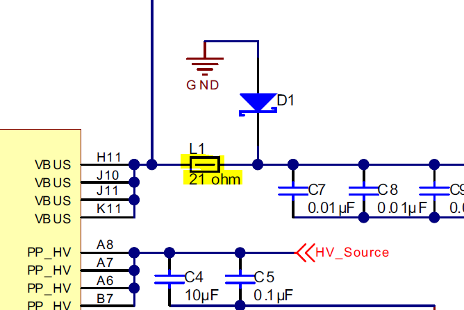

May I know what is the function of the bead in below figure?
Why I need this bead on VBUS?
Just to add couple additional notes, Inductor on VBUS line helps limiting the current and hence minimizes inrush. In addition it also helps reducing unwanted noise and ringing on VBUS thus improves EMI.
