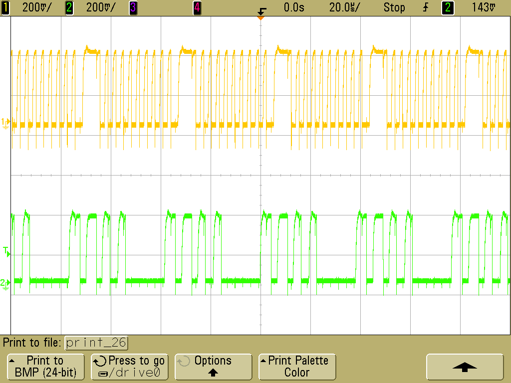

I have a problem regarding the operation of the Piccolo (F28035) I2C.
I want to write some data out the I2C port to a digital resistor located on the PCB, and I'm really stuck.  I am looking at the signals on a scope to verify what is send by the I2C, and I see that it works fine only for the first byte transfer (a total of 3 bytes).  I see the start, 1 byte of data, followed by a stop.
The big problem is that nothing happens after that.  Same routine, 1 clock, 1 data byte, and nothing.
1) I'm using I2C interrupt.
2) I am using the transmit FIFO.
3) I put Pull up resistors on the SDA and SCL
4) The yellow signal is the I2C SCL and the green signal is the I2C SDA
Can somebody help?
