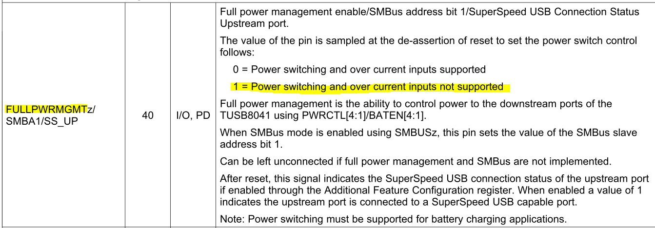

Hi team,
followed the E2E thread's questions.
USB transmission function still can't recover after OCP issue end. Customer want turn off TUSB8041 automatically report overcurrent conditions function.  Just keep HW protect. Customer tried turn off fullpwrmgmt function as below. (Pin 40 pull high with 4.7Kohm) However, it seems TUSB9041 still report overcurrent conditions for host controller.
Could you please comment how to turn of the auto report function? Need any other setting for turn off this function?
