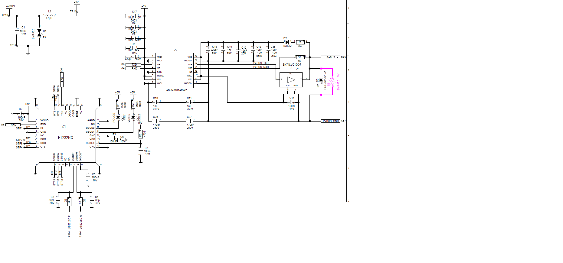

Dear all,
we are producing a USB interface based on TUSB2036, and in some case we meet trouble with the detection in the device manager. The issue is reproducible with some kind of Window 7 PC and identified interface.
An interface which always failed to be detected with KIND_PC_1 could always be detected with KIND_PC_2.
After several tests, we arrived to the conclusion that the component TUSB2036 is a major actor in the issue (soldering of a new TUSB2036 on a 'defective' interface solves the issue, and the soldering of the 'defective' TUSB2036 on a good interface leads to a failure).
In case of failure the analysis with WireShark highlights a difference during the step Port_POWER with a value put at false for the PORT_POWER instead of true, and then there is no step C_PORT_CONNECTION.
Could you tell me under which condition the PORT_POWER is set to true ?
thank you in advance for your help.

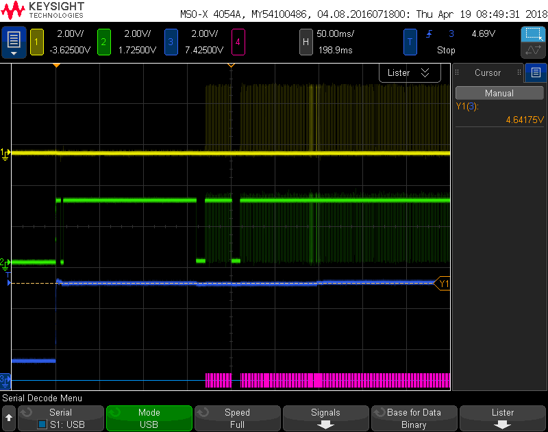

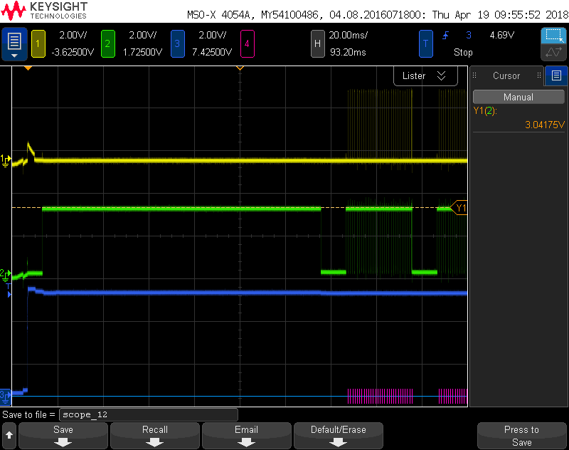

  • Hello Malik,
    thank you for your answer
    I joined to this message 3 files :
    USBInterface3_Failure_DELL5450:  FT232 and Customer device are not recognized.  (most of the case with this computer: 18/30 connections )
    USBInterface3_Failure_FT232_OK_DELL5450: Customer device only is not recognized (1/30 of the connections)
    USBInterface3_OK_DELL5450: success (1/30 of the connections)
    100 % of the USBInterface3 connections to a DELL5470 is successfull.
    100% of the USBInterface3 connections to a DELL5450 is  successfull IF USBInterface3 already connected to the PC before boot up.
    Soldering of the TUSB2036 coming from USBInterface3 to USBInterface2 leads to a USBInterface2 connection failure.
    Let me know if you need more information
      (Failure)
     (success)
     (failure)
    best regards

    please find the schematics
    thank you for your help
    best regards
    deltaDauphin
  • Hello DeltaDauphin,
    The power switch control outputs of the TUSB2036 are not routed in the schematic. Is downstream port power always on?
    JMMN
    thank you for your feedback and sorry for the delay in my answer.
    Could you explain what is "downstream port power always ON" ? how can we check this point ?
    best regards
  • OK , understood now . In our case, the port power is always ON, due to the fact that the downstream port is the USB port of the PC.
  • Yes, but in the initial problem description you mentioned that the port status does not report port power on - can you send the WireShark analysis?
  • USBInterface_2 SUCCESS PC 5450.txtUSBInterface_3 Failure PC 5450.txtUSBInterface_3 - SUCCESS PC5470.txt
    please find 3 files, explanation in the naming (file sent previously).
