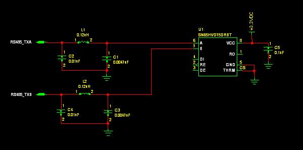

My customer has the following question.
A question came up on the SN65HVD75 part listed above.
This device is connected to an EMI filter that has a 4.7 nF capacitor to ground. There is no series device between the driver and the capacitor.

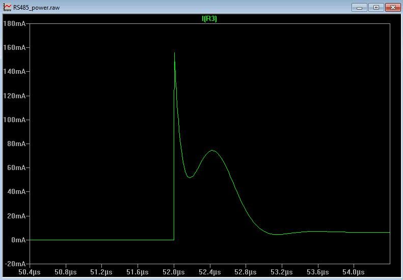

At 9600 baud rate, a 160 mA peak current is being driven by the above part for a time period of less than 0.4 microsecond, see the attached diagram. Is there any long term reliability on the part by doing this?
