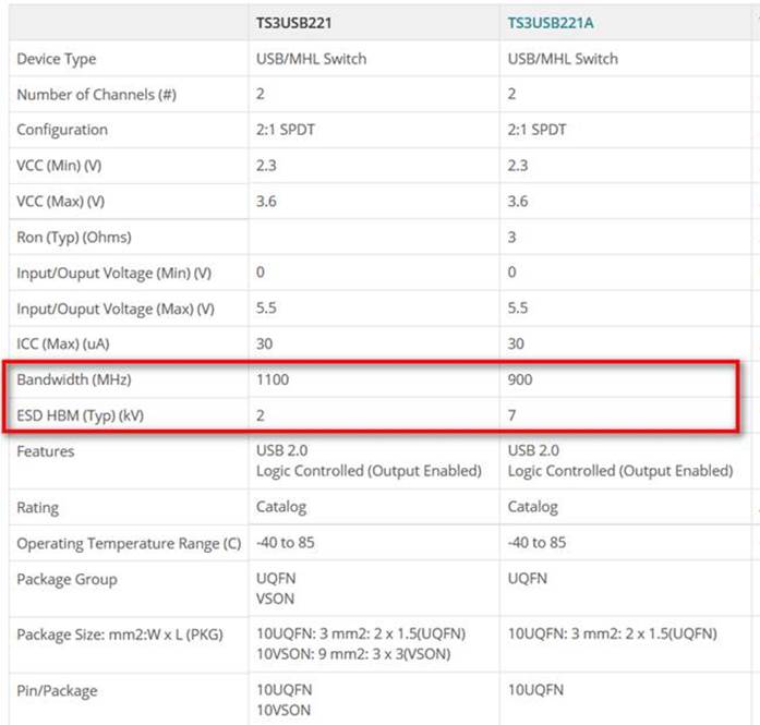

TS3USB221: TS3USB221 bandwidth
Part Number: TS3USB221
hi sir:
Custmer ask about  TS3USB221 /TS3USB221A   bandwidth. Why do you separate two type for bandwidth??
  • The bandwidth changed between the devices because we made the ESD solution more robust for the TS3USB221A vs TS3USB221. The better ESD solution decreased the bandwidth for the Device. For the TS3USB221E we increased the bandwidth compared to TS3USB221A and increased the ESD protection over both the TS3USB221A and TS3USB221.
