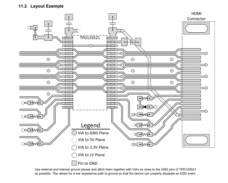

TPD12S521: please help to check the schematic and advise if the TMDS pins need to connect together
Part Number: TPD12S521
Hi,Team:
My customer using TPD12S521DBTRG4 but find can't work.
As checked, seems the TMDS pair pins such as pin 4/35, 6/33, should be connect together.
Can you help to check the schematic in attached and advise  if they must connect together? TPD12S521DBTRG4.pdf
