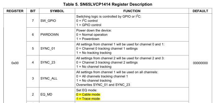

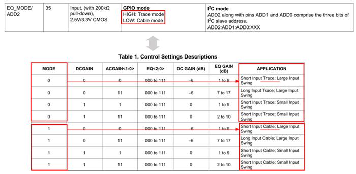

Could you tell me about SN65LVCP1414 Trance and Cable mode configuration.
Pin Descriptions is described as "EQ_MODE/ADD2 : High = Trance mode" in GPIO mode.
However, Table1 Control Settings Descriptions is described as "MODE :0 = Trance".
Which is correct?
Could you give me your advice?
