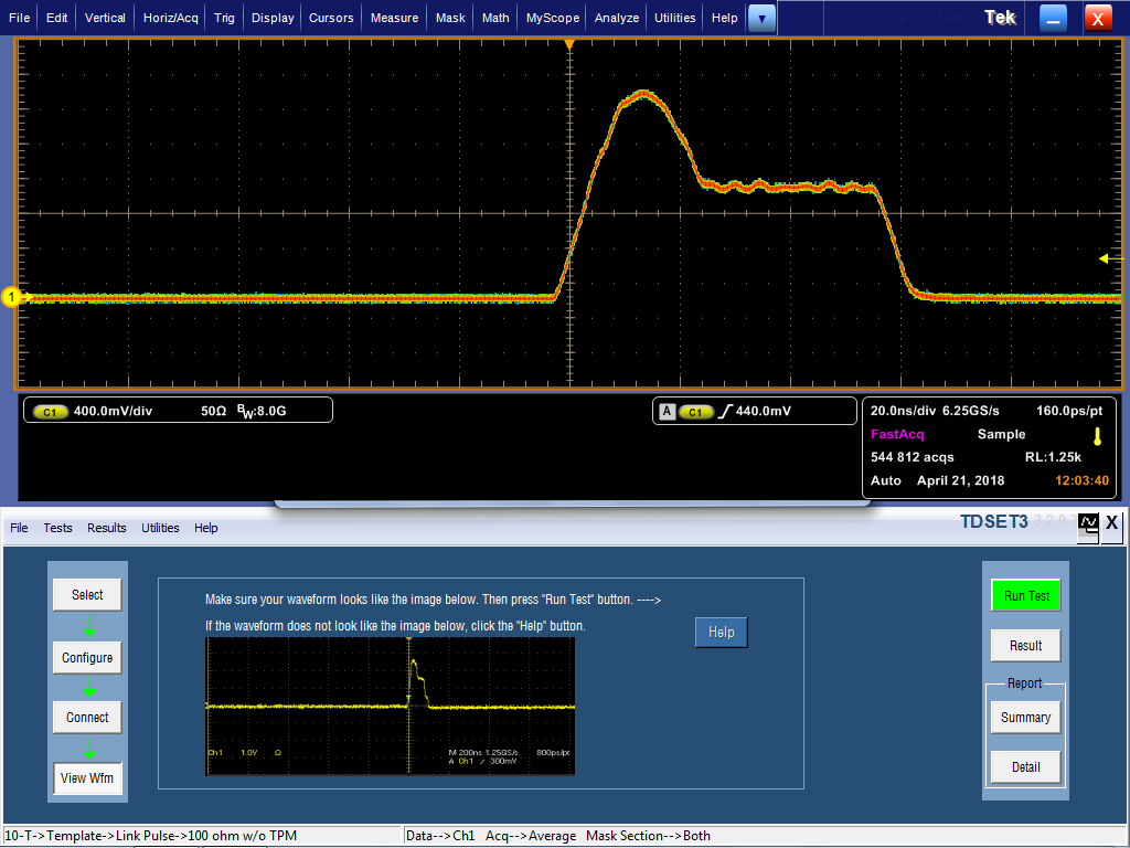

DP83848K TXD waveform is measured as attached. The high frequency noise on the signal is observed.
This high frequency noise can observe in 10Mbps case. 100Mbps case is no issue.

  • Hi Watanabe-san,
    Can you provide a schematic of the DP83848K? I will generate a 10M waveform from the DP83848K by tomorrow 4/24 in the US for your observation.
    If you have noise on the line driver, this is typically due to noise on supply voltages, or impedance mismatch by either a poorly controlled characteristic impedance on the PCB, or no load termination when probing the MDI.

  • Hi Toshihiro-san,
    Attached are scope shots of the DP83848's output waveforms, as measured on our bench from the EVM.
    Note that the same signal appears to have noise on it, when probed directly between the DP83848 and the transformer.  When probing across the 100 ohm load, there is no noise.  This is to be expected, and your probe point should be across a 100 ohm load.  This goes for both 100M and 10M modes.

  • Hello Rob-san,
    Thank you for the waveform. Let me confirm something. We measured at between DP83848 and transformar. In the same condition, we can observe same noise on the EVM. Is my understanding correct?
    I think the configuration is DP83848 -> transfomer -> 100ohm load. We measured at 100ohm load then noise was not observed. So we need to check if the noise is observed at the cable side of transformer. Is my understanding correct?

  • Hello Toshihiro-san,
    Yes, your understanding is correct.
    If probing here, you will see noise: DP83848K <-Probe-> transformer <---> RJ-45 <---> 100 ohm load
    If probing here, you will not see noise: DP83848K <---> transformer <---> RJ-45 <--->[Probe] 100 ohm load
    This is how my scope captures were made.
