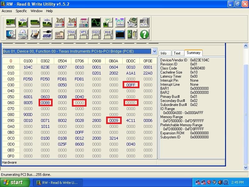

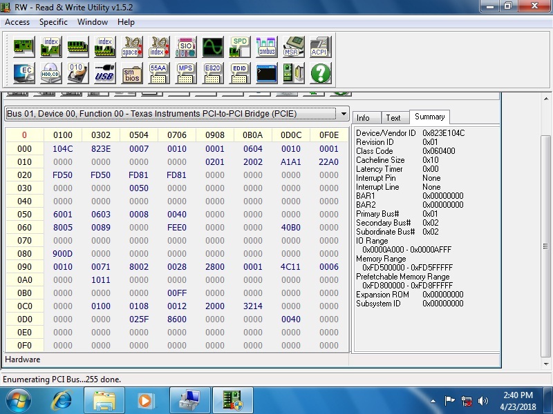

Hi Sir
We have product use XIO2213B
if use for Win7 or Win10 there is no problem
but use for windows XP ,it will have below yellow mark
1. May I know any driver I need to update ?
2. Any register I can check first ?
XP Register (Fail)
Win7 (Pass)

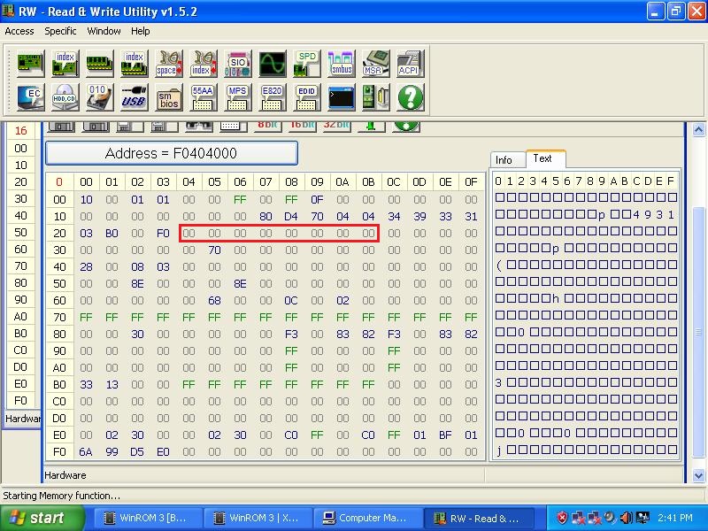

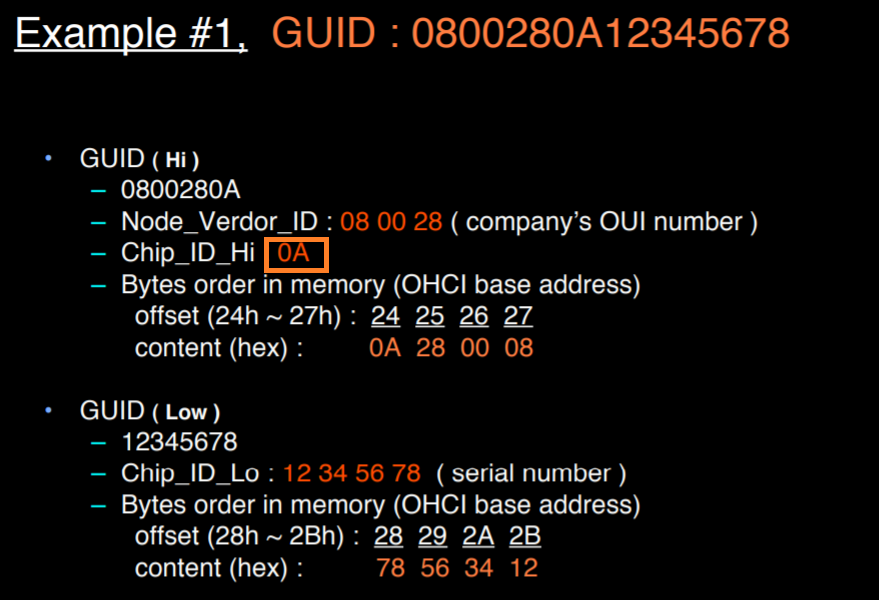

Hi Yaser
We program GUID 29h~30h into EERPOM
But when the system going to OS , the OHCI address 24h~2Bh will not change to our setting from EEPROM
XIO2213B SCL SDA have already pull up to 3.3V ,may I know anything I need to do
PS. when we use RW tool to program EEPROM 29h~30h ,the yellow mark will disappear ,but this is online tool ,when we restart the system ,the register will change to default 00

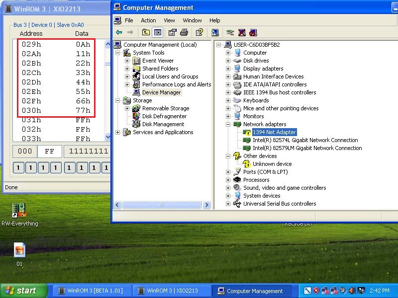

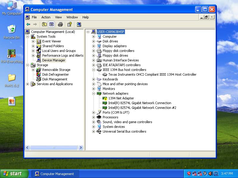

Hi Yaser
As I mention ,if we program EEPROM for GUID in XP OS ,The yellow mark error will be disappear
I use WINROM to program eeprom ,but the eeprom can't be read by XIO2213B after power on
We buy a 1394 card and de-pop EEPROM than pop this eeprom on my card ,the issue can be solved ,so I think the H/W maybe workable
Could you provide the reference EEPROM file ,I will use the reference EEPROM file to modify or if I use EEPROM ,which register need to be modify
