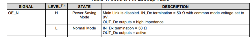

Q1. What is transition time when DDC buffer is changed from enable to disable by DDC_EN ?
Q2. What is transition time when DDC buffer is changed from disable to enable by DDC_EN ?
Q3. What is transition time when Main Link is changed from enable to disable by OE_N ?
Q4. What is transition time when MAIN Link is changed from disable to enable by OE_N ?

    OE_N:
    I would like to control Main Link activity by HPD to reduce power consumption during DVI monitor is not connected.
    When HPD= high (DVI monitor is connected), normal mode.
    When HPD= low (DVI monitor is not connected), power saving  mode.

  • You will have to invert the HPD for OE_N if you want the device to be in normal mode when HPD is high and in power savings mode when HPD is low.
    We do not know the transition times that you requested. the transition time might be short enough depending on how long the Denounce is on HPD and how long after HPD goes high the host starts sending information.

    Please see following figures. Here is my question. I would like to know td1, td2, td3 and td4.
    Timing.pdf
    Chiba.
  • From testing a device in the lab the td1 and td3 are about 50 uS and td2 and td4 seem to be about 125 uS.
