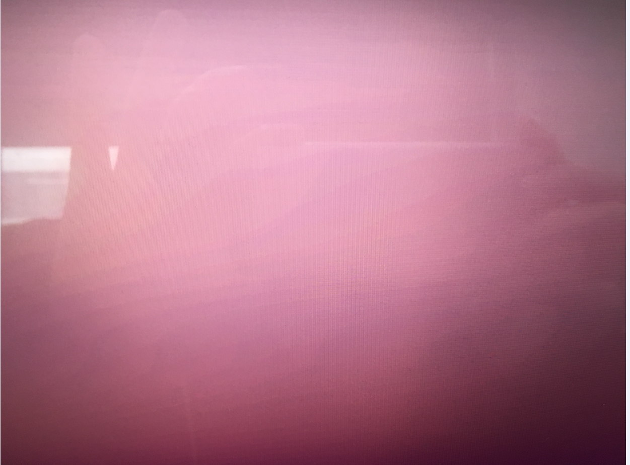

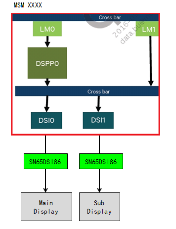

He designed Qualcomm platform with 2 pcs 18-bit displays.  Below is product of block diagram.
Both main display and sub display are the same NV140FHM-N41.
Below is NG picture.    Both main display and sub display had the problem.
Set SN65DSI86 REG[0x5b] = 0x01 ( 18bpp loose format ) , it can't solve this problem.
My customer used  Qualcomm platform DSPP0 function to slove main display problem.
But sub display still has problem.  Please help us.   Attached PDF is Panel Datasheet.
