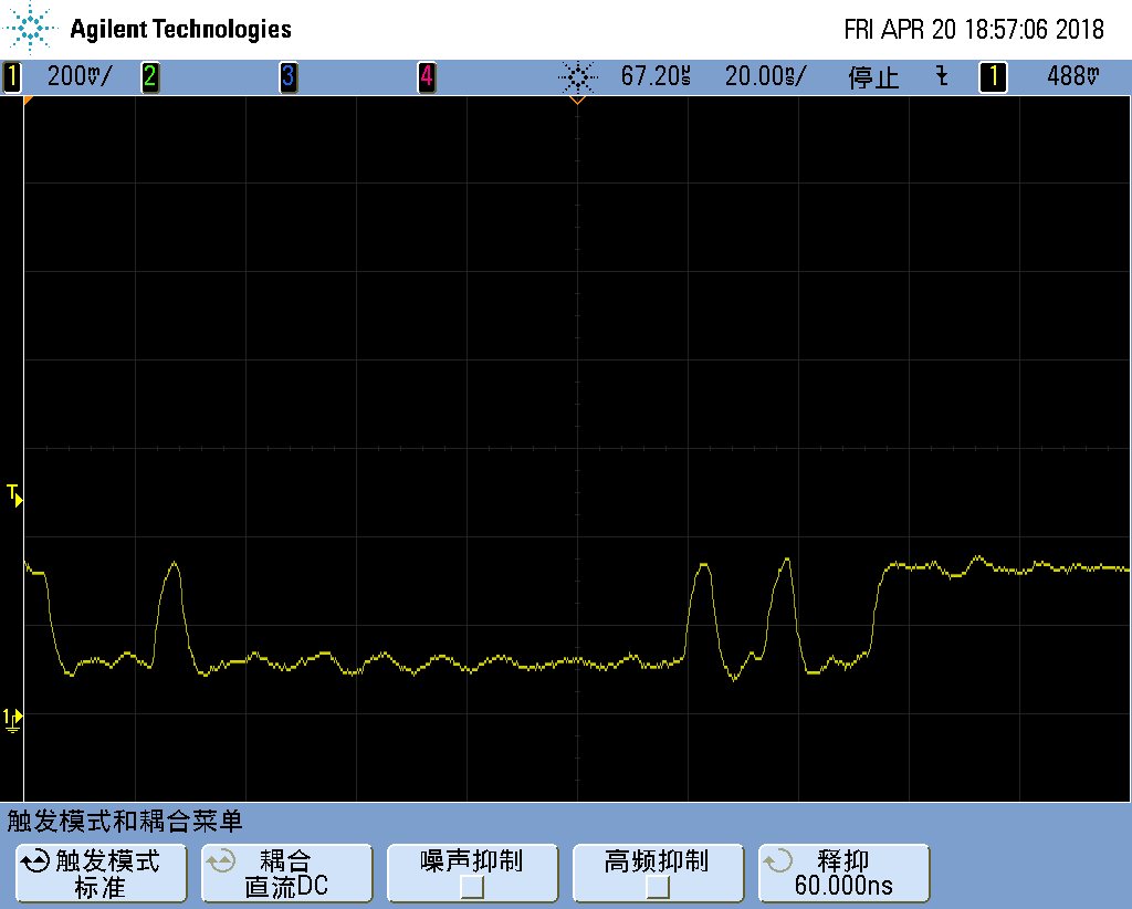

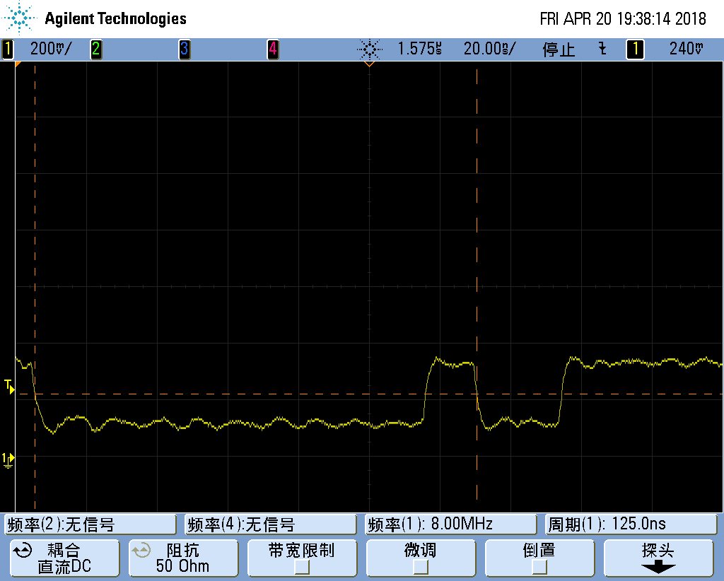

This project si RK3399 -> SN65DSI83 -> 1024X600lvds screen;
Now the CPU(RK3399) Can't display through sn65dsi83,but test pattern is ok,
1.read 0XE5 = 80,--what  situation wil have this err report ;

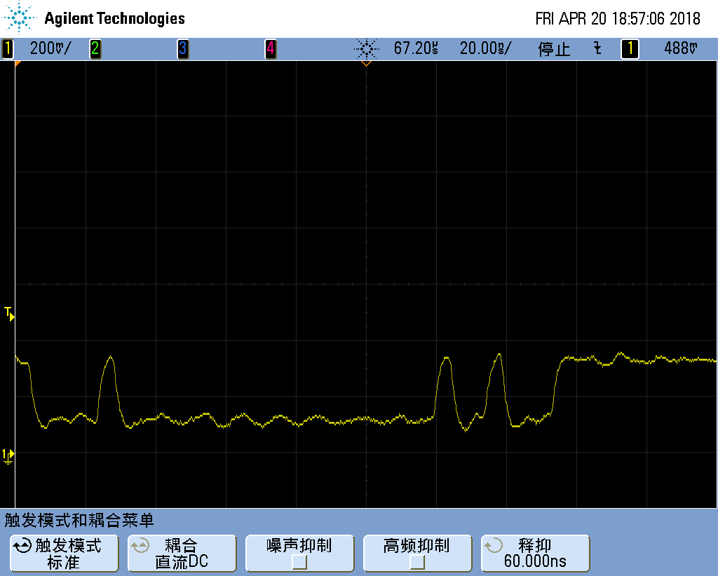

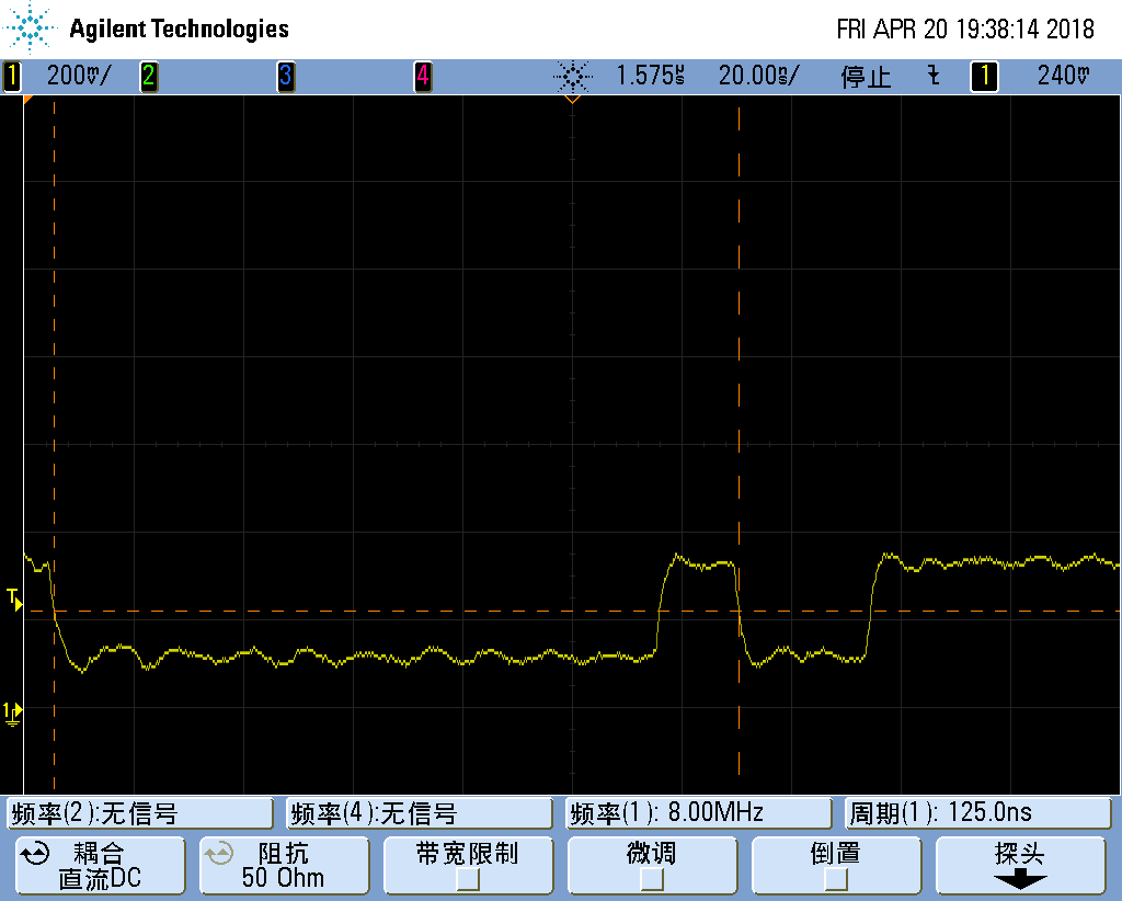

2.Oscillograph probe test on data lane,there willbe two error below:
3.Before EN pull high there is more than 10ms low;
4.HSS, 0x21 0x00 0x00 0x12
5.VSS_ one package incloue four bytes,0x01 0x00 0x00 0x07
6.
before change SOT,SYNC ERROR report,after change SOT error report.
For normal SOT is ok ,DSI83 can recognise this sequence,but maybe receiving VSS and HSS package the err report .I haved checked the wave , it is right;

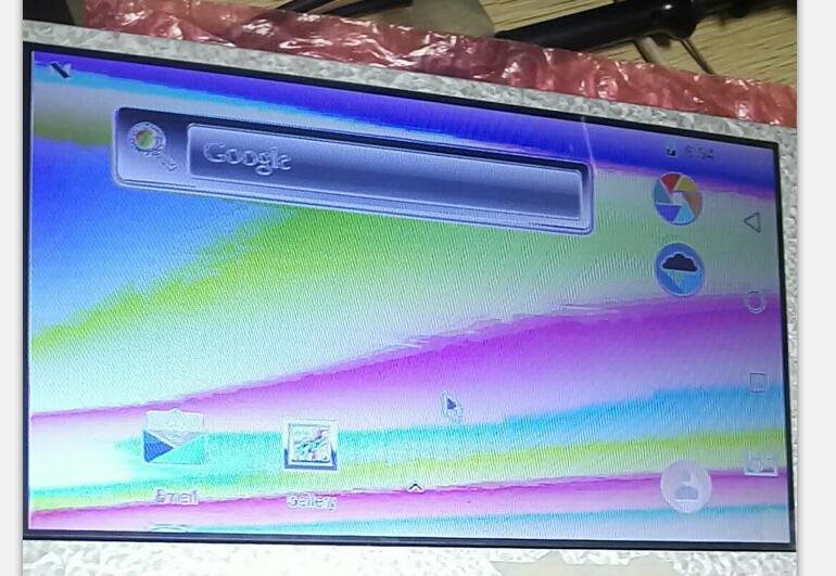

  • Dear I.K
    The driver is following the sequence in Tablet 2,now the cpu grapth is out,but the color is wrong;
    the csr txt color ng below.Please help to check.
    24bit 1024x600

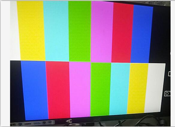

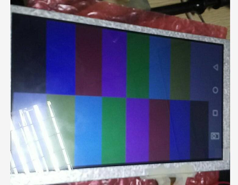

    screen display color NG.
    HDMI color ok for compare.
  • Dear I.K
    The wrong VCOM voltage cause this issue;
    Now the display is OK.
    TKS

  • Dear I.K
    1.0x10 bit5 must be 1,or there is err;
    2.Vcom must be powered right with 4.5v.Wrong color the Vcom supply current is not enough to be 1.5v.
