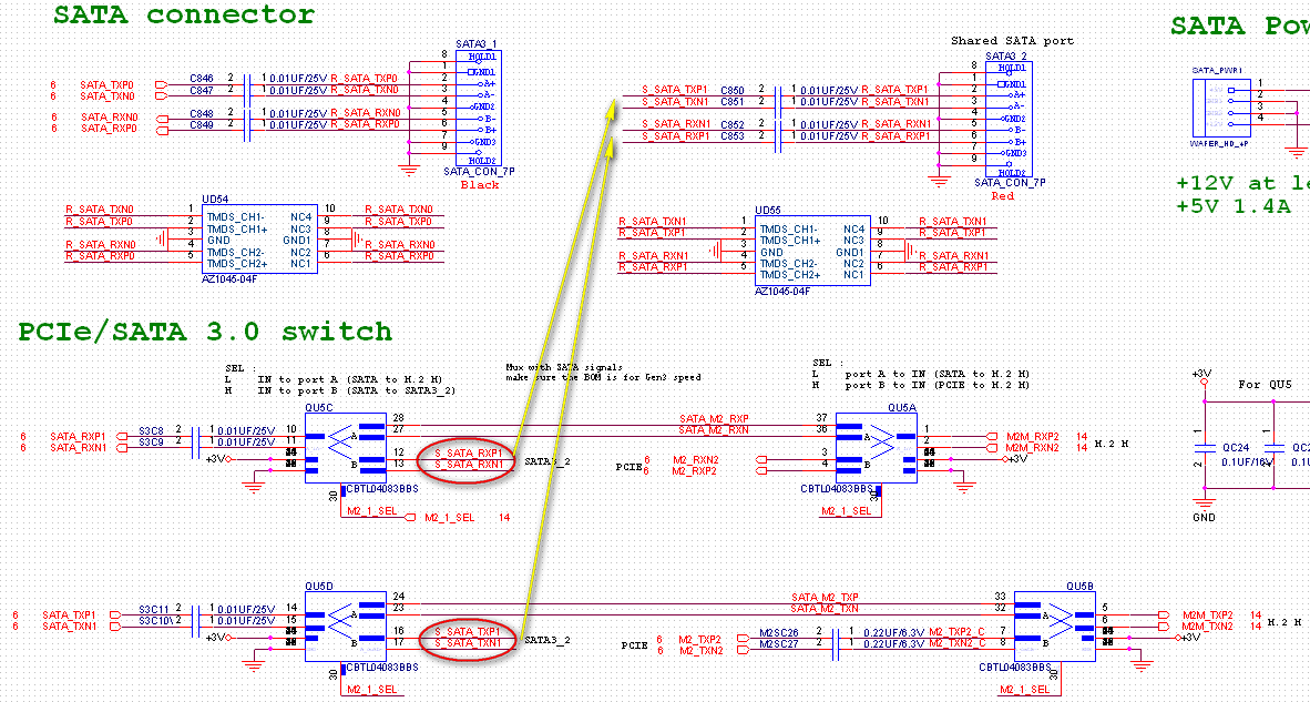

Hi Sirs,
We would like to use HD3SS3415 to replace CBTL04083
Please help double confirm our schematic:
HD3SS3415.pdf
Some question need confirm.
1. SATA GENIII AC CAP. is 0.01U, Do we need add AC Cap in port B? That mean there have ac cap. 0.01U on in/out both side
2. Same as port A. If switching to port A, do we need add AC CAP?
When switching on port A. there will have other PCIE GEN III to switch then to M.2 M. Like QU5A/QU5B
1. QU5B/QU5A port B still need add 0.22U AC CAP? M.2 TX need add AC CAP.?
