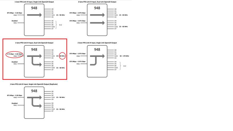

    We are planning to use  DS90UB948  deserilizer with attached JDI display  ,
And seriliser as DS90UB929 ,
Deserilizer LVDS configuration as given below ,
1-      Display frequency is 55Mhz , but desrilizer Max frequency is 48Mhz ,will it be any issue?
2-      Seriliser DS90UB929 is fixed and display is also Fixed , is there any solution to use any other desrilizer ?

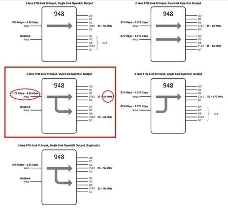

  •     As per our understanding 96Mhz is for input side maximum clock frequency  of the single channel FPD-Link side,
    But we want to know in Open LDI output side [display side ] maximum frequency as per the below configuration , In datasheet it is mention as 48Mhz is the maximum ,
    Or could you please check whether the attached LCD can s upport for 948 desriliser with single channel input ?
  • Hi   Junqiang Shi
        Can we use 55Mhz dot frequency display  in  below configuration , but why bedsheets is showing 48Mhz is the maximum for below configuration [1 lane FPD III input 2 lane open LDI out] ?
  • Hi, Please check the block in figure31 that you mentioned "48MHz". it is limited by the 1-lane FPDLink input. as you know, when 1-lane FPD-Link input, the receiver data rate is 3.36Gbps max, and maximum PCLK is 96MHz. In this condition, of couse the output LVDS clock is maximum 48MHz for dual OLDI output (or 96MHz for single OLDI output).
    In your application, please understand the PCLK freq. For both UB947 and UB948, the input and output PCLKs are same!
