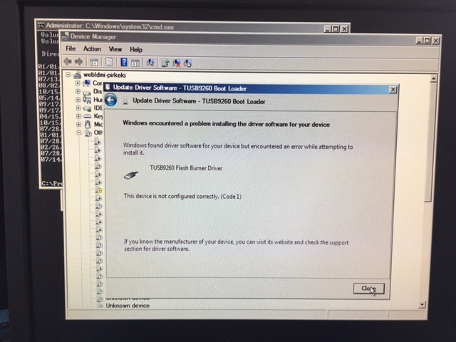

1. Drivers: I got this picture from device manager.

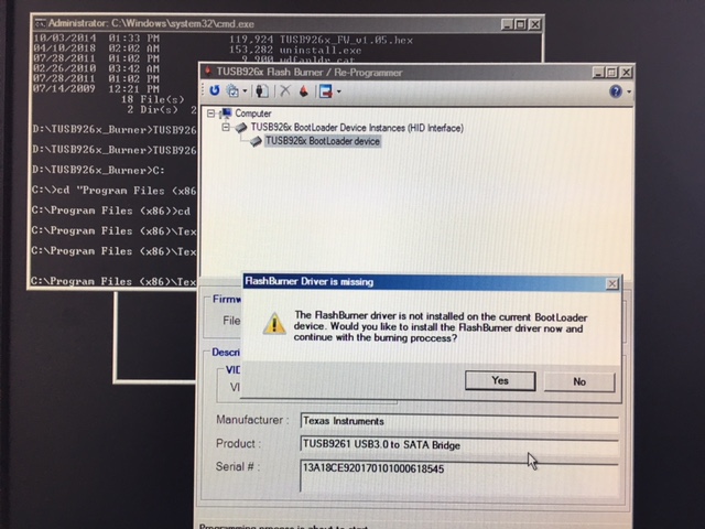

2. Application. This is what I have. When I try to flash the device, the following error logs appears
"The flash driver is not installed on the current Boot Loader  device ... "
and when I try to install them from the app:
"Unable to get the path to the FlashBurner driver. Please rescan your list ... "

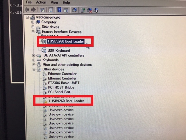

3. Double checking driver status, I got this message:
I already removed regedit stuff regarding Lower and Upper registers (Windows-side), but I'm still blocked.
