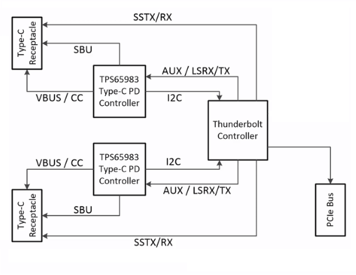

    We've been waiting for a couple of months for approval from Intel to get TB3 developers access, the latest go-round for approval was rejected because "Two ports cannot be BPD (Bus powered device)", the topology submitted was basically lifted from a TI presentation (the picture below).
    In the meantime our design progresses the best we can with the information available to us.  My initial read of the the available information for TB3 and power delivery was conceivably you could have a chain of several bus-powered/self powered devices, all powered from a single USB-C power adapter like shown below, true?  Stupid question?
  • Hi John,
    You're correct about self-powered devices (bus-powered devices) with TBT3 ecosystems, but when it comes to monitors this falls under a different protocol. Each monitor is powered externally through a power adaptor to a wall. The laptop, of course, doesn't need to be powered from a wall outlet. The main purpose of daisy chaining two monitors is for the data and not the power.

  • Thanks Aramis,
    I'm not sure why monitors are brought up, our product application involves multiple data protocols in the field, TB3 would support this better than say USB and daisy chaining is attractive.  What's not attractive is the prospect of each unit being externally powered.  I was sort of hoping TI had considered the scenario above and had a solution to offer, or at least some guidance.

  • Hi John,
    If you're connecting non-monitor bus-powered devices (like your drawing above), this should work. I believe you can daisy-chain up to six 15W devices to a laptop. In reference to the monitor, monitors consume a ton of power and hence the need to connect them externally.
    When building a TBT3 ecosystem, one must first contact Intel for a reference design that suits your application.  Secondly, TI will provide the exact FW to flash the PD controller needed for your exact reference design (no customization on the GUI).  Intel tells customers using TBT that customization is NOT allowed in order to have TBT certification. One must follow the reference design and copy all of the components used.
    With TBT devices, TI must follow what Intel tells us. I hope this answers your question, and for more details on TBT ecosystems, please contact an Intel Representative for assistance.
