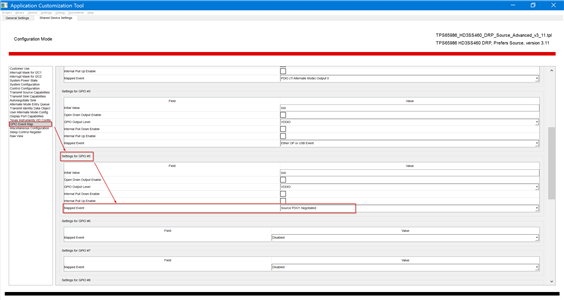

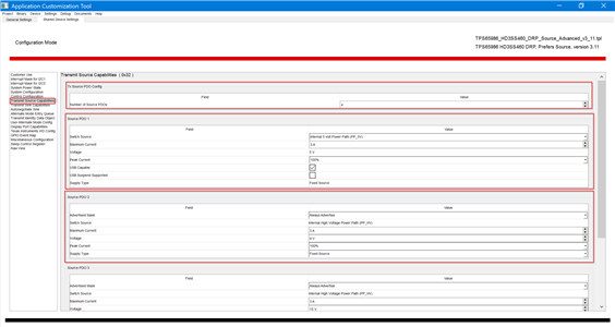

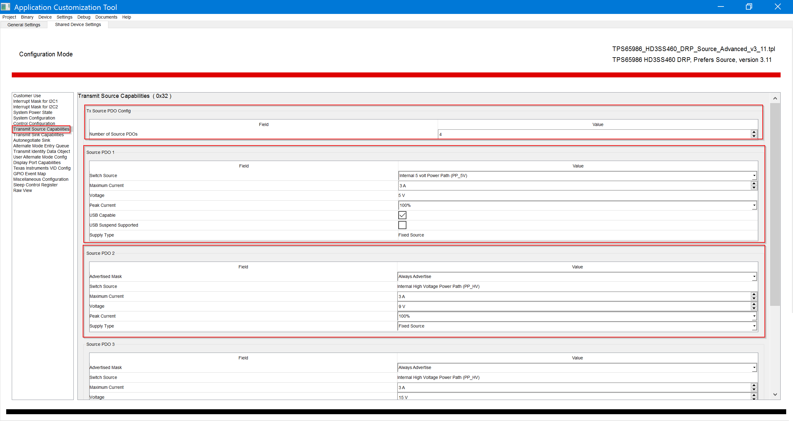

    If TPS65986 is configured as the source, the GPIOs can be set as the picture below.
    First, set the source capabilities. Here we set 4 PDOs: 5V/9V/15V/20V.
    Then GPIO Event can be set in “GPIO Event Map”. Let’s take GPIO5 as an example and set “Mapped Event” to “Source PDO1 negotiated’’. When 9V is negotiated successfully, GPIO5 will become high and can be an input for other parts.
