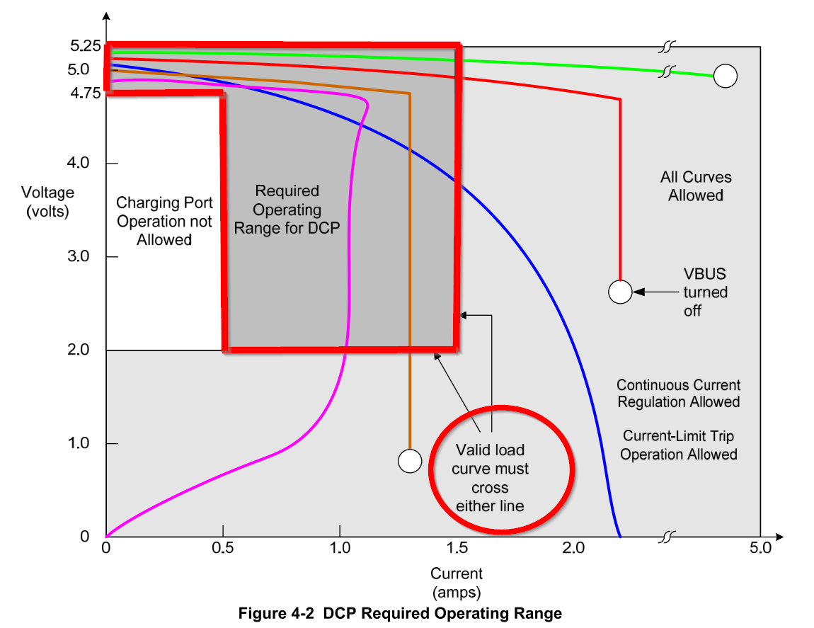

  • This answer about allowed DCP power levels is NOT true, to my understanding.  Per BC1.2 spec, one of the updates from BC1.1 to BC1.2, was specifically to allow DCP to output more than 1.5A.   Figure 4-2, in section 4.4.1 seems to specifically show a Green Line that goes up to ~4.75A, and comment "All Curves Allowed".  I tried to paste below, hopefully it comes through.
    However, I understand for DCP, D+/D- should be shorted, and as you found, the Apple Charger had 2.7V, which is clearly not shorted.   Any recommendation on how to deal with these, and get more of the available power from the charger?   (SDP reporting will cause current clamp at 500mA, to be spec compliant, right?)

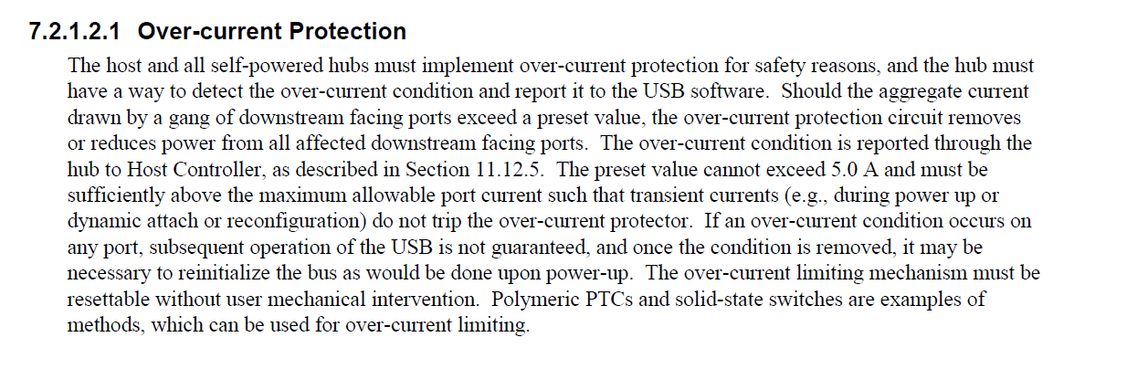

    Unfortunately, your understanding about DCP seems to be not correct. The required operating range for DCP is in the thick red box  shown in the picture below.
    As for the 5A in the picture, it’s the requirements from USB2.0 spec, please refer to USB2.0 section 7.2.1.2.1 and read carefully.
    As I mentioned, Apple adapter doesn’t apply to BC1.2. So there’s no way to do the detection for Apple adapter with TPS65986.

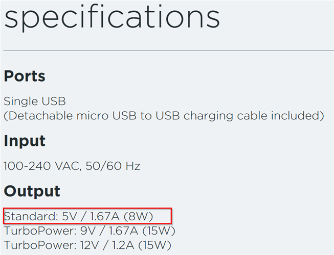

  • Update to this question....   we better understand and agree that the original 2 chargers are not BC1.2 compliant, and TPS65986 does not have non-compliant charger detection feature.   However, we've done some testing with a new charger we believe is BC1.2 compliant, and are getting varying detection report sometimes as DCP, sometimes as SDP.  Would like to understand if you have any ideas, or have done any testing with this charger:
    Motorola:  https://www.motorola.com/us/products/turbo-power-15-wall-charger
    Characteristics
    • VBUS [no load] ~5.1V
    • D+/D-  ~15R (zero(0) voltage drop across this pins)
    Observation(s):
    1. Detection is still inconsistent. Failure rate as high as 20% where detected as SDP.
    2. It seems that there are periods when the detection is consistent even after 20 retries. But when it detection start's failing i.e. SDP detected, failure rate is as high as 20%.

        From the description of the Motorola wall charger, it's not a BC1.2 compliant product. Please make sure the charger used by customer is a real BC1.2 compliant one.
