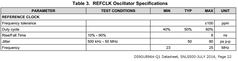

The datasheet specifies the frequency tolerance of REFCLK as +/-100ppm.
Does this include temperature variation?
i,e. the frequency tolerance should be within the range(+/-100ppm) under whole operational temperature range.
Or is this just for room temperature condition?
