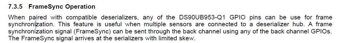

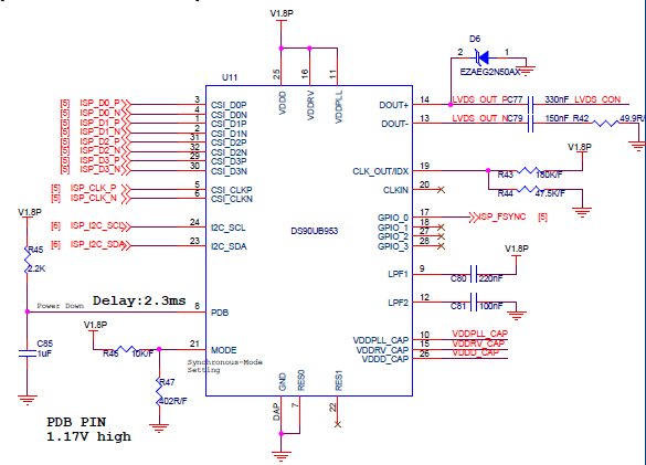

I connected to GPIO_0 (pin 17) to use Frame Sync function.
If it is according to datasheet, there seems to be no problem. Please check that there is no problem.
