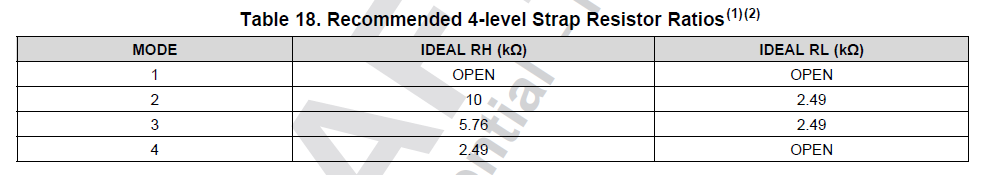

         There are 5 problems of DP83TC811S-Q1, please help to answer:
                   1, If my customer use SGMII interface, need set  MAC(2-0) :000
And the 4 level bootstrap as below, does it mean SMGII interface only in Mode 1(RX_P, RX_M)?
       Can customer used the resister to set the mode of RX_P and RX_M? Does the MAC interface and Strap mode conflict?

  • Hi Eric,
    1. Yes, the DP83TC811S defaults to SGMII 4-wire mode.

  • Hi Rob:
         The fourth problem, customer need to selected ESD device, so can you help to check the max run rate of TRD_P/N?
         The first problem :  "Can customer used the resister to set the mode of RX_P and RX_M? Does the MAC interface and Strap mode conflict? "  Please help to check again.

  • Hi Eric,
    The edge rate of the TRD_P/N is 15ns - 18ns
    Yes, the register can set the mode of RX_P and RX_M. MAC interface strap only only sets initial operating mode. Operating mode can be changed later. There is no conflict if setting does not match strap.
