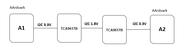

iwanted to know if have some Restriction in using 2 TCA9617B devices,"back to back" as appears in the drawing below?
Shahaf
  • Hey Shahaf,
    Your set up should be fine so long as the sides where both TCA9617B are connected are using A side. B side should be connected to the aardvark on both sides which will have a 0.5V offset when pulling low.
