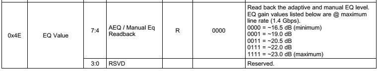

Can you please elaborate how adaptive equalizer operate on DS90UB914A-Q1?
<Q1>: Start-Up / Restart
After power up of DS90UB914A-Q1 or refume from loss of lock condition, how can device find a best EQ setting?
Does it start either from minimum or maximum EQ setting?
What is the condition to select the best EQ setting?
<Q2>: Gain Accuracy / Variation
There is no specification related to the gain accuracy and/or variation compare with the value specified in resigter table below.
Do you have any of numbers, ranges or indication of this variation?
<Q3>: Possible AEQ Failure and CMLOUT of PRE-AEQ
Can we expect the failure of AEQ? Let's say, the AEQ function in several devices would have worse equalization performance. That finally cause the received signal degradation. Is that a case?
Also, we have CMLOUT pins to make sure the signal of post AEQ. Do we have any ways to check the waveform pre-AEQ?

  • Ken,
    Can you provide more information/background on the issue and what they are seeing?
    1. What is their channel length and loss and what type of cable?
    2. What is the line rate and PCLK frequency?
    3. Are they using AEQ or manual EQ setting? (Register 0x4D[6] and register 0x04[7:4] controls this)
    4. Is the behavior only on one or specific no of devices and is it repeatable?
    5. What is their device power up/system start up sequence?
    Are they meeting the power-up requirements and PDB pin as per section 9.1.2 in the datasheet?
    Also it is important to follow the proper system level startup sequence - i.e. the 914A should be reset with the proper signal present at the input from the serializer so the AEQ can perform optimally and lock to the correct values. This can be done via either PDB pin or digital reset 1 via I2C.
    Please refer to the DS90UB914A device datasheet section 9.1.4 and 9.1.5 for information on channel loss, channel requirements for 913A/914A and AEQ loss compensation.

    Let me ask quick one. Do we have any signal path other than CMLOUT to capture the signal before AEQ?
    (Added: may be after backchannel separation and before AEQ)
    Ken
  • Ken,
    No, CMLOUT monitors the post-AEQ stage i.e. after adaptive equalization.
  • Hi Palaniappan,
    We know their cable length (>10m), however, we have not performed its insertion loss measurement.
    10bit mode with around 60MHz PCLK, thus line rate would be 840Mbps.
    My customer use AEQ
    Yes, it would be reasonable to check CMLOUT waveform with various 0x04[7:4] settings.
