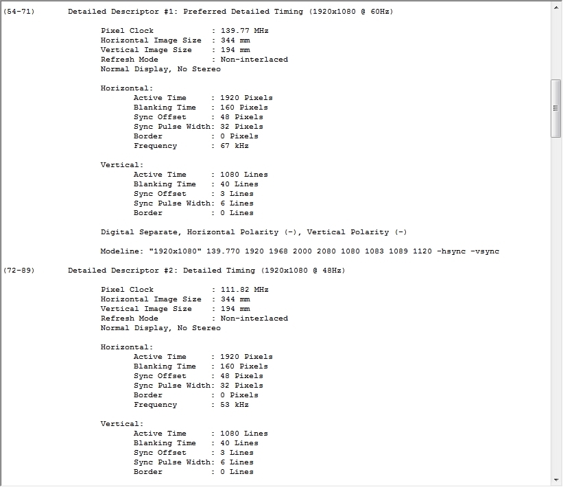

  • Hi Malik
         Thanks for your reply! Following picture is the panel EDID read data. And the next data was reply from Campbell 4/28 I think.
    We use the setting but can't display even color bar. Customer need to set 0x96 be 0x01 can display out color bar.
    I also ask them modify like 0x5a form 0x0D to 0x0C, and 0x12 to 0x42 or 0x43 ( RGB666 can calculate 148.5Mhz*18/8=334.5Mhz=42H)
    Can I got some useful information from 0xF0~0xFF int reg ?

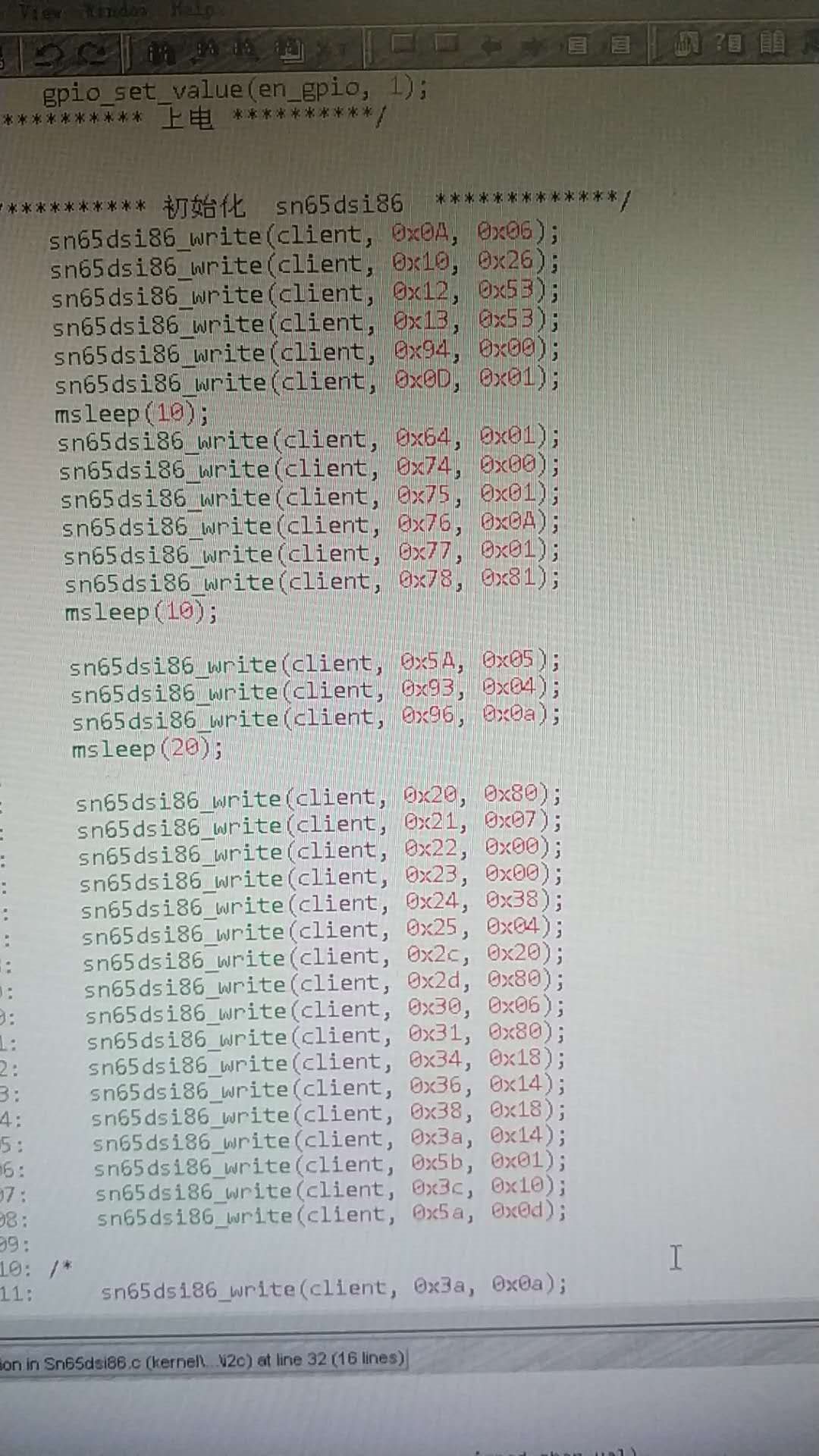

    And the follow picture is customer setting structure. We had do some modified. I don't have final setting picture. I had find some setting on E2E, seems like this.
    Please help us check where could be wrong.
    Thank you so much!
  • Bruce,
    Try changing the resister values as listed below, this may help gaining the proper functionality for your panel.
    0x0A = 0x02
    0x12 = 0x3E
    0x13 = 0x3E
    0x2D = 0x00
    0x31 = 0x00
    0x34 = 0x50
    0x36 = 0x1F
    0x38 = 0x30
    0x3A = 0x03
    0x93 = 0x20
    You are using RBR, HBR or HBR 2? To confirm your only using DSI A Lanes correct?
    Could you post a block diagram of the application? This will help debugging some of the errors found in the 0xF0-FF registers.
