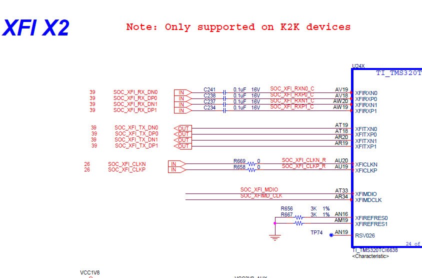

Hello, I'm trying to find a PHY for the 10G Ports on the 66AK2H14 ARM+DSP. The processor has XFI outputs and support 10GBASE-KR. The datasheet for the TLK10034 on page 156 states, "The device can also be used for optical physical layers (like 10GBASE-SR or 10GBASE-LR) by interfacing to optical modules requiring SFI or XFI electrical signaling." That's the only mention of XFI in the document. My question is will this device be able to interface with the ARM+DSP, or should I keep looking for another PHY?
