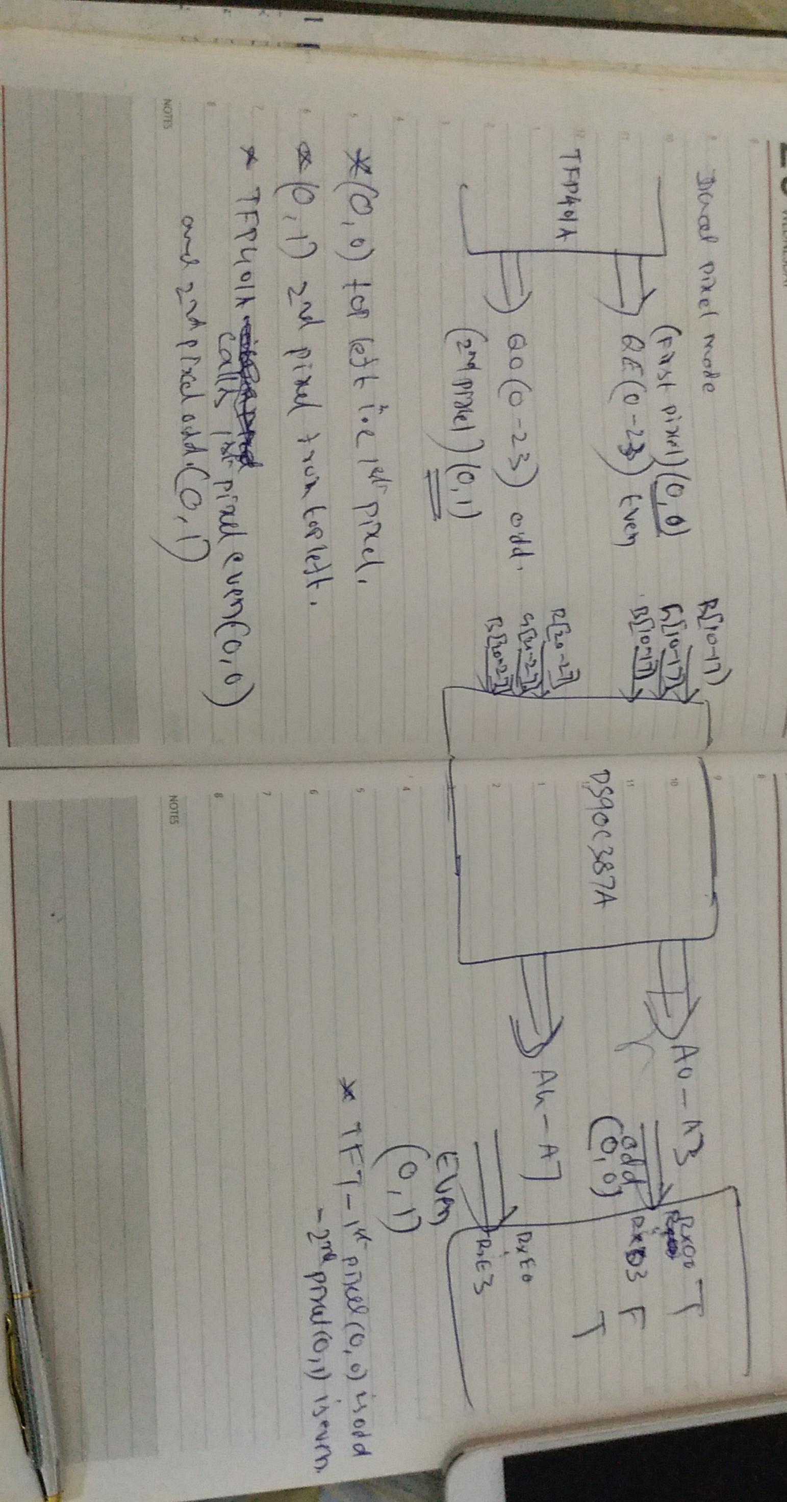

Our tft calls 1st pixel (top left and 0,0) as odd and 2nd pixel (0,1) as even. We connected A0-A3 of 387a to odd pixel i/p of tft and A4-A7 of 387a to even pixel i/p of tft.
So we want first pixel (i.e even pixel as per TFP401 and top left (0,0) ) to come out from A0-A3 and 2nd pixel (i.e odd as per TFP (0,1)) from A4-A7 of ds90c387a.
