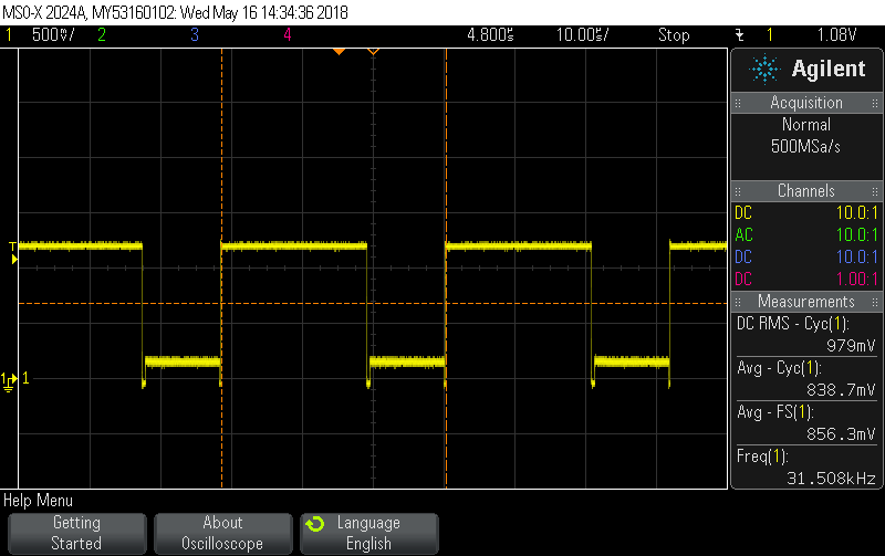

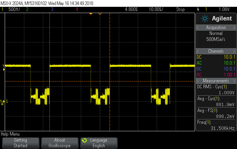

  • Hi Steven,
    1.  UB954 has CSI2 output as the waveform below:
    2. the waveform of CLK
    3. When 953 connect to a camera, use 2 lane can get the signal on 954, and I can see the image on the monitor.
    But when 954 use the sample code to generate colorbar, CSI2 could output sugnal as the attached waveform, but can not see anything on monitor.
    At the CSI receiver side, it will show TIME OUT whild camera dis-connection in normal condition,
    but when customer do pattern gen at 954, even there is no camera connected, but receiver can not get TIME OUT massage.
    Thank you.
  • Chentsu,
    can you check the receiver side is set correctly? does it need continuous clock output?
    best regards,
    Steven
