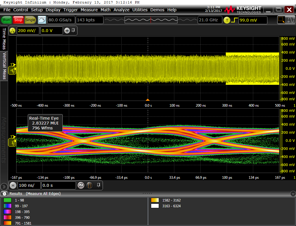

    I see that our MODE setting differs; HIGH = Continuous Talk, LOW = SAS Mode, Fast OOB. (I also see mention here that MODE = 0 is important for SATA: e2e.ti.com/.../1183105. Do you think this is a likely culprit for drive detection after system power on?  We have had mixed results -- we can go for hundreds of successful boot sequences without failure, and then be hit with a rash of failures for no good reason.
    Does the MODE setting have any impact on communications after the link is established? If not, we may have multiple issues since we have also encountered PHY CRC error messages (thrown by Linux kernel) which I believe are related to signal integrity. I have probed inputs/outputs of chip on high speed scope and the buffered/driven output of DS64BR111 don't appear to be great. I have attached a photo of what I am seeing.
  • Also, I think the design original was set with MODE: 1k to VDD based on recommendations here: e2e.ti.com/.../1958962
  • Hi Joushua,
    What are the EQ and DEM configuration pin settings? This signal looks over equalized. We can start by improving the waveform and see if it eliminates the errors you have seen reported by Linux.
    Lee

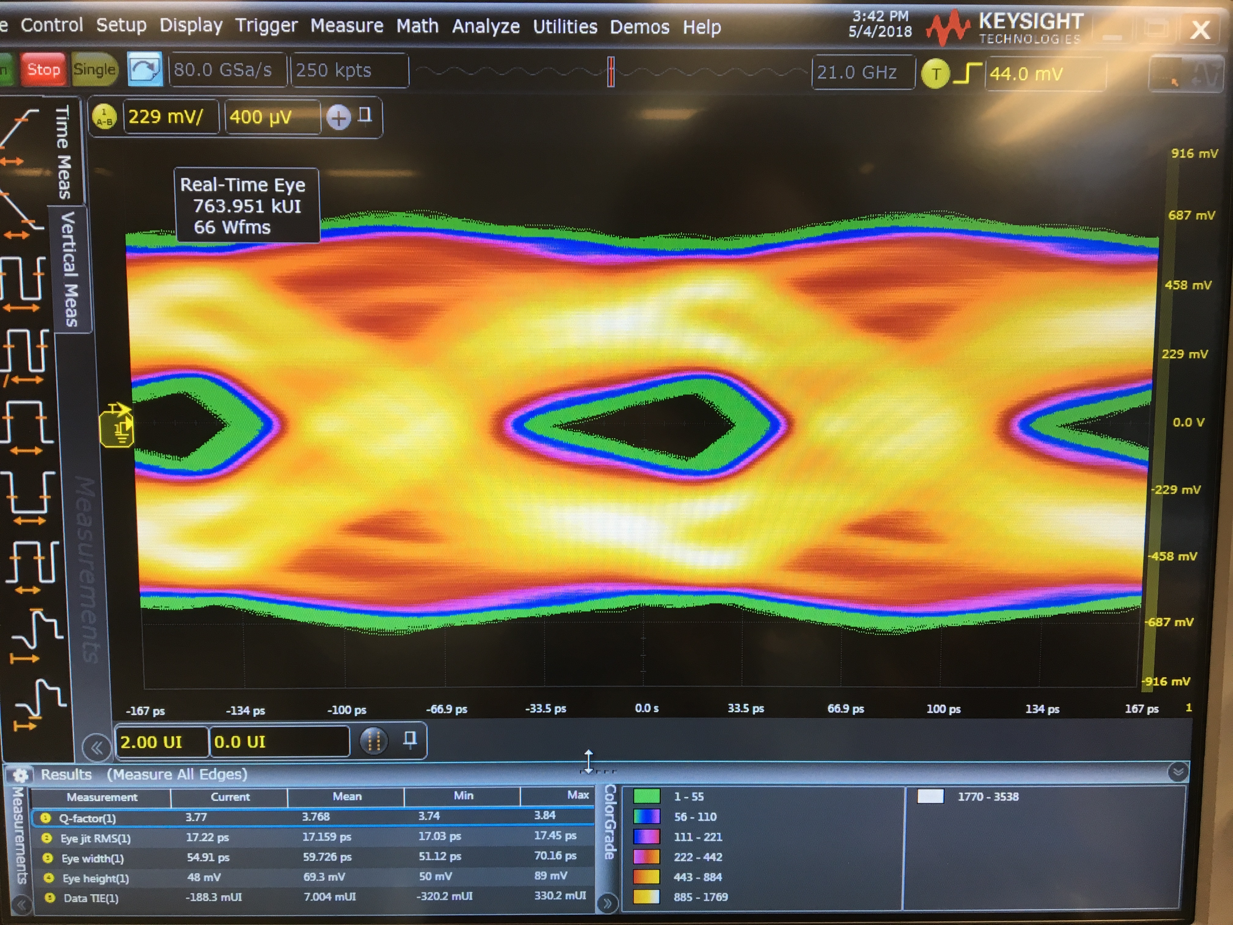

  • I have made the changes suggested.
    Functionally the design still booted. However the eye opening seems to have closed more relative to my previous observations -- height and width.
    I assume that some differences in eye measurements can be attributed to differences in probing (though the same test equipment was used); but the overall characteristics of the eye don't seem to have changed significantly.
    I have attached another screenshot.
  • Joshua,
    Based on the eye crossing there is a large amount of deterministic jitter which cannot be compensated for with a linear equalizer.  This could be the probing location, but I think there is also some PCB structures impacting the eye quality.  Could you send me some pictures of the system with DS64BR111 locations and measurement points annotated?  It would also help to get the native board file to look at the PCB in detail.  send to lee.sledjeski@ti.com

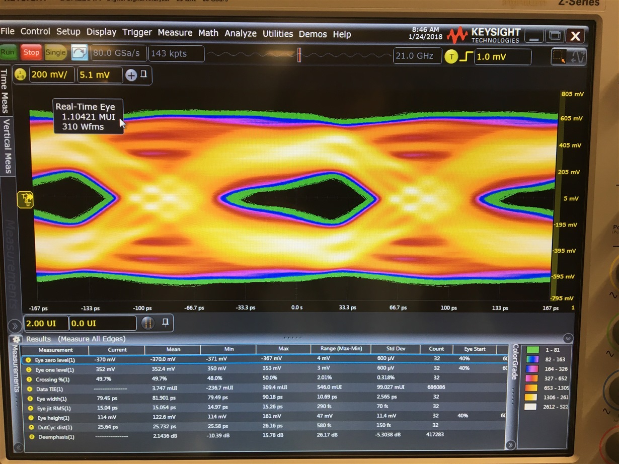

  • For reference, here is what the eye looks like at the input to the redriver (INB):
