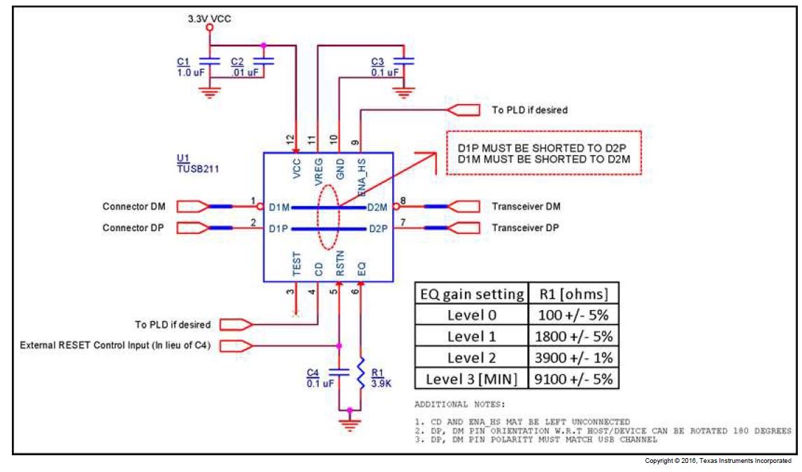

Hi team,
My customer wants to use the device TUSB211. But the datasheet says the D1P must be short to D2P. We want to check why. Thanks.
BR
Frank
