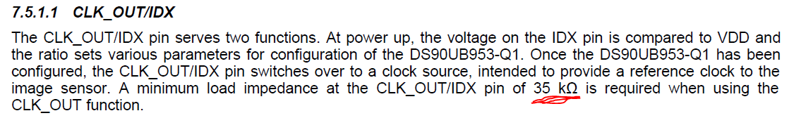

DS90UB953-Q1: The ds90ub953 datasheet page 24 says the min load 35kohm, what does it mean? Do we need to pull up or pull down to the CLK_OUT/IDX pin?
Part Number: DS90UB953-Q1
Hi team,
The ds90ub953 datasheet page 24 says the min load 35kohm, what does it mean? Do we need to pull up or pull down to the CLK_OUT/IDX pin? Thanks.
  • Hi Frank,
    The IDX function requires two resistors; Rhigh and Rlow in Table 8 and Figure 11. One goes to 1.8V and the other to ground.
    The recommended resistors in Table 8 meet the 35k ohm requirement. If you select resistors other than the ones we recommend, make sure the load impedance is 35k ohm or greater.
    Mike
