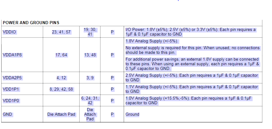

But they Have given VDDA1P8 as 1.8V analog Supply and VDDA2PA as 2.5V analog supply VDD1P1 as 1.1V analog Supply VDD1P0 1V analog Supply
Analog Supply is nothing but one which varies with time interval ... Then how it will be a DC Supply
