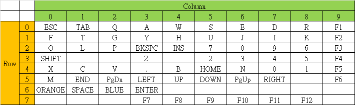

Hello Sirs,
For this 80 Key scan IC . Is there problem pressed three keys at the same time ? Under Android O/S .
Is there any concern about key mapping as below ?
Appreciate your experience sharing !
  • Hey Terry,
    It is possible to still see a ghosting event occur from this configuration. I would suggest using diodes on the switches to prevent this.
    This is an article that talks about using diodes:
    This is another one that also discusses this and even recommends a diode to use:
    -Bobby
