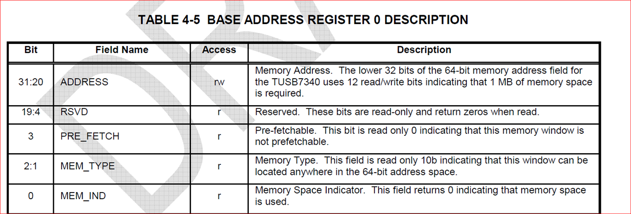

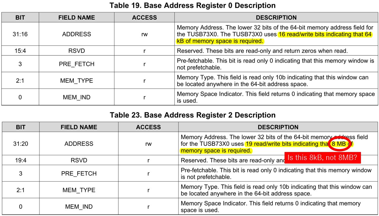

Please let me ask about required memory space described in Base Address Register 0 and Base Address Register 2. It's 64kB for Base Address Register 0 but Base Address Register 2 requires 8MB. I think that 8MB is too large so it should be 8kB. Is my understanding correct?
I found that some user 64kB and 8kB as following thread.
