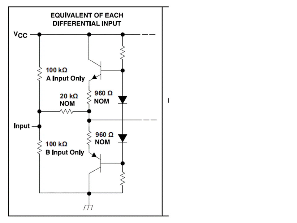

Hi team,
My customer wants to get equivalent schematics of DS26LS32A differential input
in order to review and fix the old designed external fail-safe circuit of the device.
Please provide the equivalent schematics.
