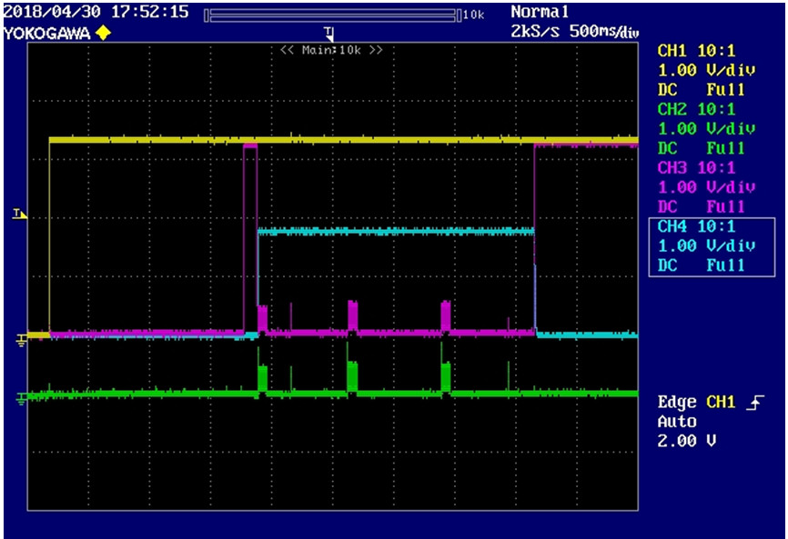

Hi Team,
We double confirm the waveform on TUSB211 EVM, and get the fail waveform when the device can not be recognized.
USB structure as below.
USB Host-->5m cable-->TUSB211 EVM-->20cm cable-->USB device.
We tried every EQ setting on TUSB211 EVM, or even chnge to TUSB212 EVM, but still got the same fail waveform.
Could you help to verify what issue cause this fail waveform and cause device can not be recognized?
(CH1-VBUS, CH2-DM, CH3-DP, CH4-VREG)
