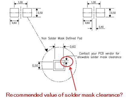

How much is the recommended value of solder mask clearance?

    As it says in the datasheet that is based on your PCB manufacturer but we have a recommendation.
    "Check with your board fabrication site for solder-mask openings, but typically the NSMD openings are 0,1 mm to 0,14 mm larger than the lead finger pad size. For a lead pitch of 0,5 mm, it is recommended to design the solder mask around all pads on each side with a clearance of 0,05 mm or smaller, so consult your board fabrication site for tolerance requirements."
    Again this is all based on the PCB manufacturer not TI. As long as the pads are not shorted together it should work.
