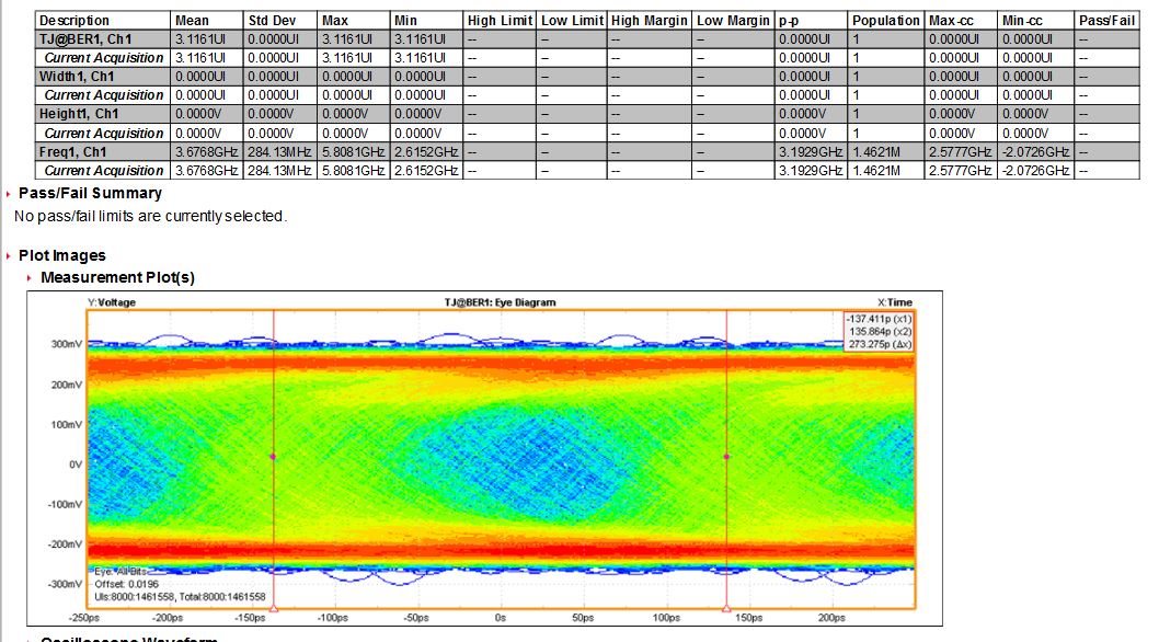

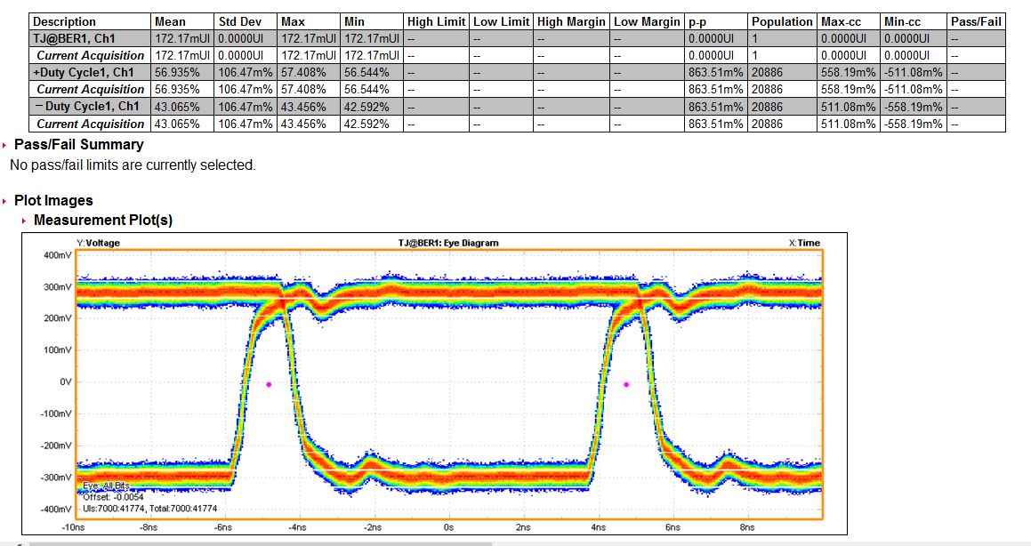

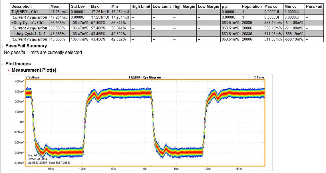

4, We have test ub947 input clock jitter and ub948 eye diagram as follows in   in 25 degrees
Single Clk jitter data report waveform such as attachment " input clk" , test value 0.017251UI < 0.2UI
Read out Clk jitter data waveform reports such as attachment " input clk-2" , test value is 0.17217UI < 0.2UI
Use differential probe-direct  point ub948 to mark two points as follows: output point yellow, register with prepared 0 x 56(3) to 1 Enable
Test results report waveforms such as attachment "data": no eye map at all
Question:
     1, Are there any other suggestions for rectification on ub947 or ub948?
