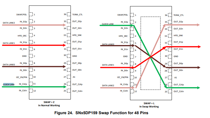

Reading specs of DP159:
In section 7.6 diff inputs characteristics says that max clock lane rate = 340 MHz
In Figure 24: with SWAP = L it shows that data_lane2 is applied to IN_CLK pins

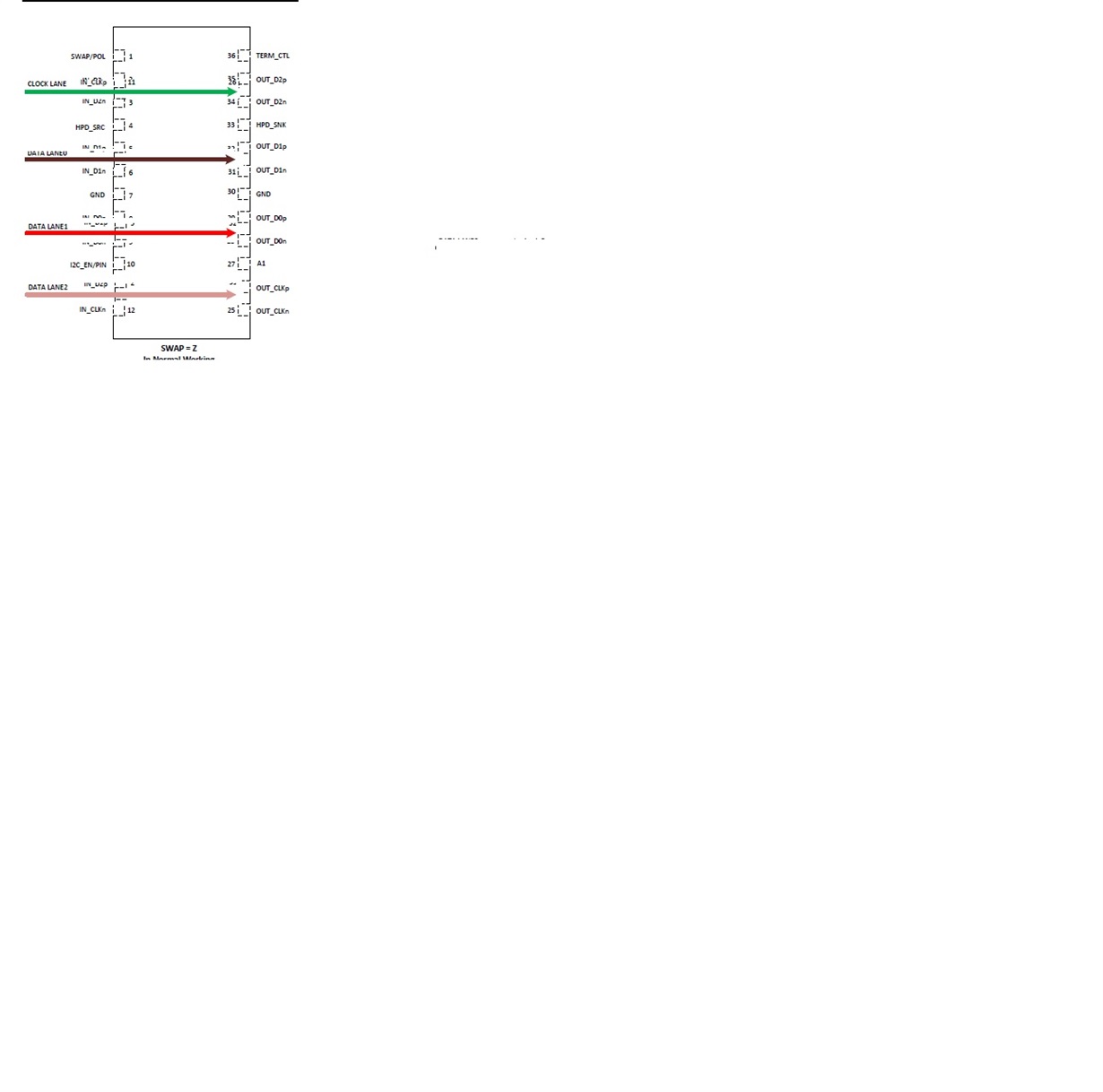

These 2 info are kind of contradicting.   I would like to use the DP159 with data_lane2 to IN_CLK, data_lane1 to IN_D0, data_lane0 to IN_D1 and clock_lane to IN_D2 but in normal working SWAP =Z (straight throught).  Is it possible when my data_lanex rate is ~ 5Gb/s?

  • Lam,
    This configuration is possible because all lanes of SN65DP159 are electrically equivalent. The clock lane is specified this way because of the PLL associated the clock lane. So in SWAP =L mode, IN_D2 has a max of 340 MHz because the PLL is associated with IN_D2 and feeds the output to OUT_CLK.

  • Lam,
    1) Q:Does it mean the OUT_CLK will always be limited to 340 MHz and cannot handle 6Gbps?
        A: Yes it is limited in retimer mode because of the PLL. The PLL allows for the retiming capability of the part and is not specified to lock onto a 6 Gbps clock. SN65DP159 clock lane output is specified at a max of 340 MHz for retimer mode because in this mode it is always connected to the PLL. Refer to image below from datasheet.

  • Lam,
    This won't work, the redriver / retimer can swap which input it is expecting the CLK signals to be received on, but it cannot swap the outputs. The output clock is always on pins 25 and 26.
